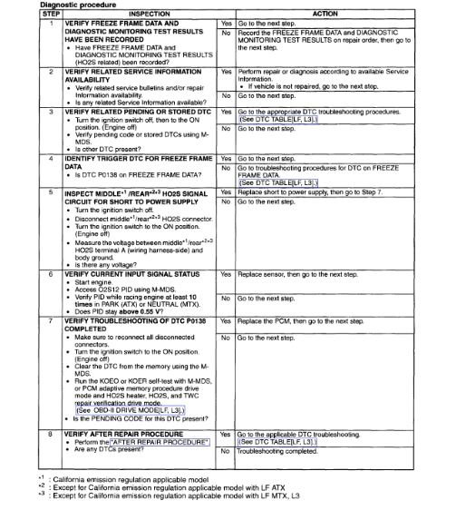

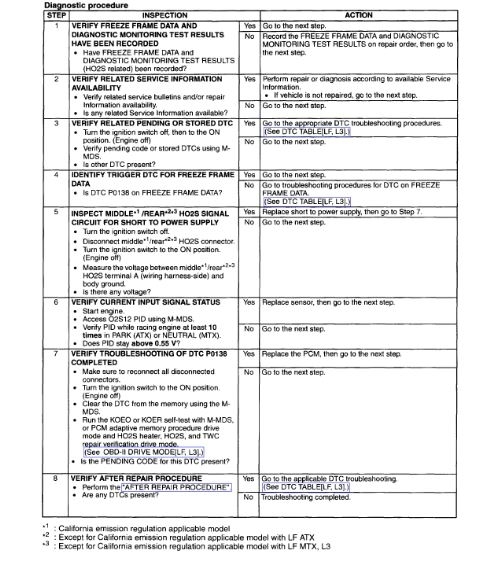

I attached the flow chart below for you to test it.
P0138
Descriptor
Probable Causes
Middle and or rear Heated Oxygen Sensor (HO2S)
Powertrain Control Module (PCM)
Flow chart
+1

I was following that flow chart to step 5 and that is where I measured 12V on terminal A to body ground (I believe terminal A should be 0V?). This was with the O2 sensor unplugged and probing wires on the harness side.
I believe there is a short to power somewhere in the wiring harness but am unsure how to proceed to narrow it down.

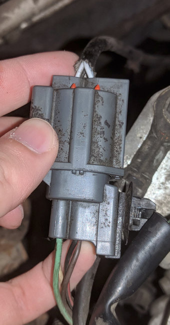

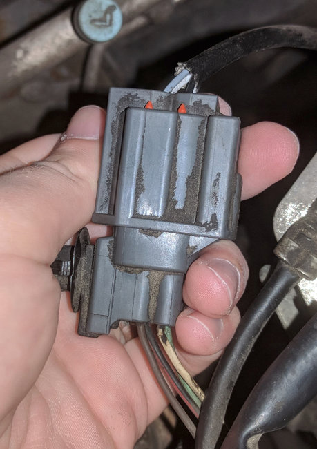

Sorry for dropping out of existence for a while, we went on vacation. Here are some pictures with measurements (my assumptions in brackets), let me know what you think:
In the first image you can see:
Grey (sensor signal)
Wire harness side -> brown
Black (sensor signal gnd)
Wire harness side -> white
I measured brown to white and got 0V. I also measured brown to body ground and got 0V.
In the second image you can see:
White (heater power)
Wire harness side -> green
White (heater ground)
Wire harness side -> black/red
I measured green to black/red and got 9.16V. I also measured green to body ground and got 11.85V.
Does this seem normal? I believe according to the service manual's steps I should replace the sensor, but let me know what you think.
Once again thanks for all your help! Really appreciated.
- Konrad
Sunday, September 1st, 2019 AT 1:41 PM
Yes, replace the sensor.
