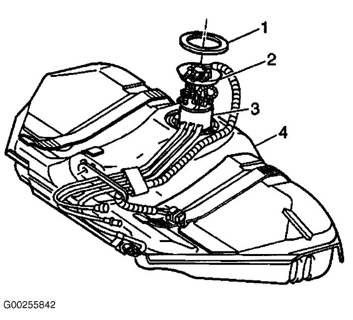

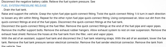

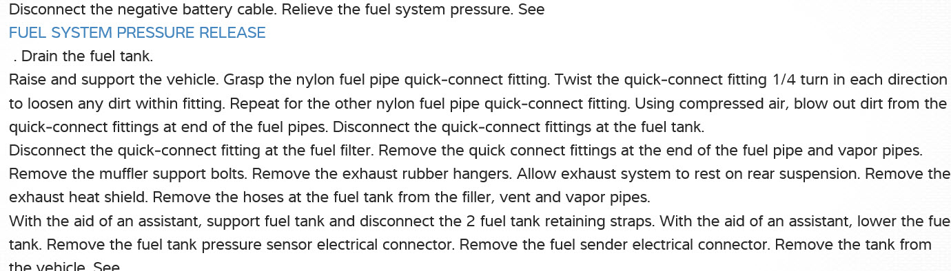

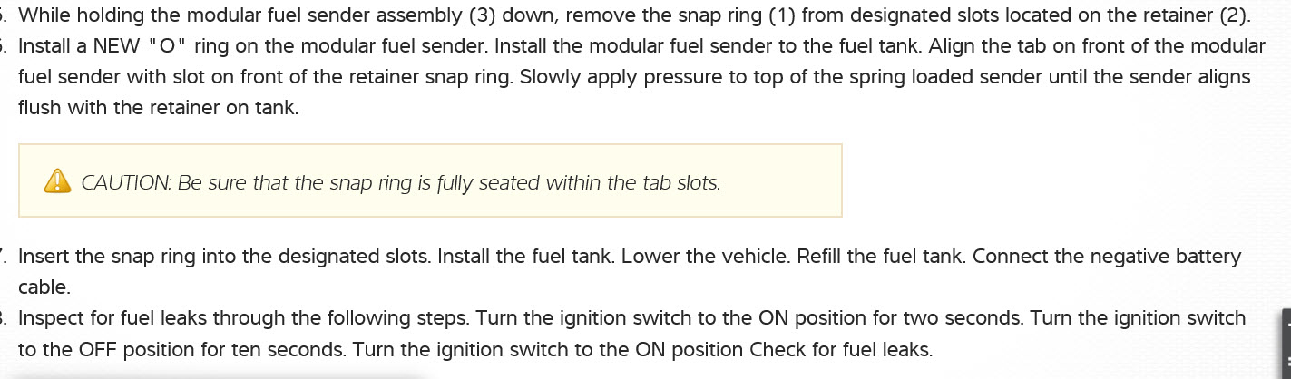

How do I remove the fuel tank?
Wednesday, August 24th, 2016 AT 8:03 AM
HMAC300
MECHANIC
48,601 POSTS
See pictures this includes removing fuel pump module.
