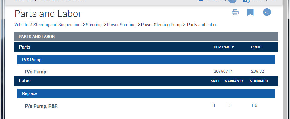

How many hours does it take for a mechanic to do the job of replacing a power steering pump? Can I do it myself?
Sep 20, 2019 at 4:20 PM
This is not a difficult repair and it all depends on your comfort level.
Here is a video on how to do it for your vehicle. Let us know what questions you have on this.
https://www.youtube.com/watch?v=EXDysSOs07g
As for the amount it would cost to have it done. I attached the part and labor information. You take the labor hours and multiple that by the shops door rate per hour and you will get pretty close on the labor.
Let me know if you have questions on any of this. Thanks

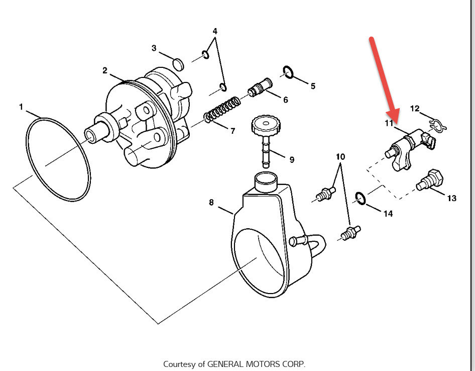

Mechanic says there is an actuator for the power steering pump and it is leaking. The cost to fix it is $649.00. Is there an actuator on my Tahoe?
Jan 18, 2021 at 1:36 AM (Merged)
HMAC300
  • 48,601 POSTS
there is what is called a variable assist actuator that is part of pump. He is probably going to replace the pump assembly. it is item 11 in the picture. This video will show you how to change the pump out so you can get to the valve with diagrams below.
https://youtu.be/EXDysSOs07g
Check out the diagrams (Below). Let us know what happens and please upload pictures or videos of the problem.

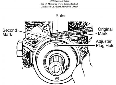

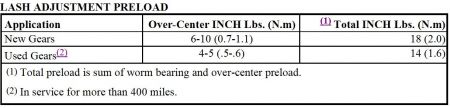

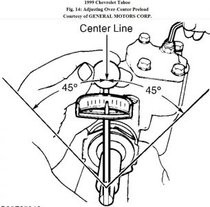

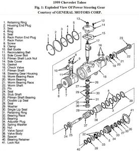

I recently replaced the power steering gear on my tahoe; at the same time I replaced the pitman arm and power steering hoses. After draining and refilling the pump with fresh fluid I tried to bleed the air from the system by first removing the coil wire and turning the engine over while turning the steering wheel back and forth, then did the same with the engine running, making sure to keep the pump full. At first the steering was easy, then it started to get more difficult to turn the wheel. On the test drive I noticed that the wheel is difficult to turn (maybe only 50% power steering) and that there is more play in the steering wheel than there was before changing the gear (wheel freely rotates 20-25 degrees back & forth). Does it sound like the stiffness is because there is still air in the system? How can I determine whether the PS pump has failed? Any way to adjust the free play out of the wheel or do I need to go through the trouble of getting and swapping out another rebuilt gear?
Jan 18, 2021 at 1:40 AM (Merged)
MERLIN2021
  • 17,250 POSTS
HYDRAULIC SYSTEM BLEEDING 1. Fill reservoir to correct level. Allow fluid to settle for no less than 2 minutes. Start engine and run for 30-60 seconds, then turn off. Check fluid level and add fluid (as necessary). Repeat procedure until fluid level in reservoir remains constant. 2. Raise and support vehicle with both front wheels off ground. Start engine. Turn wheels right and left, lightly contacting stops. Check fluid level and add fluid (as necessary). 3. Lower vehicle. Turn wheels right and left, slowly from lock to lock. Turn off engine. Check fluid level and add fluid (as necessary). If fluid is foamy, allow vehicle to sit for a few minutes and repeat bleeding procedure. WORM BEARING PRELOAD 1. Remove steering gear from vehicle and mount in vise before performing preload adjustments. See STEERING GEAR under REMOVAL & INSTALLATION. Remove worm bearing adjuster lock nut. See Fig. 1 . Using spanner wrench, turn adjuster plug clockwise until plug is seated in housing. Torque should be about 20 ft. lbs. (27 N.m). 2. Index mark housing even with one hole in adjuster plug. See Fig. 13 . Measure back 1/2" counterclockwise from first index mark. Mark housing with second index mark. Rotate adjuster plug back counterclockwise until hole in adjuster plug aligns with second index mark on housing. Install and tighten adjuster plug lock nut. Ensure adjuster plug remains in position. Fig. 13: Measuring Worm Bearing Preload Courtesy of GENERAL MOTORS CORP. OVER-CENTER PRELOAD 1. With worm bearing preload adjusted, rotate stub shaft slowly from stop to stop while counting total number of turns. With stub shaft positioned at either stop, rotate stub shaft back 2/3 total number of turns counted. Stub shaft should be back to exact center position. Flat on stub shaft should be facing upward and parallel to side cover and master spline on pitman shaft should be aligned with adjuster screw. 2. Turn pitman shaft adjuster screw counterclockwise until extended, then back off one full turn. Place INCH-lb. torque wrench in vertical position on end of stub shaft. Measure gear over- center torque by rotating torque wrench attached to stub shaft in a 90-degree arc, 45 degrees on each side of center. See Fig. 14 . Record highest degree of arc on each side of center. Record highest reading. 3. Turn adjuster screw in until torque required to rotate stub shaft is 6-10 INCH lbs. (.6-1.1 N.m) greater than reading in step 2 . Continue adjustment until over-center reading is within specification. See LASH ADJUSTMENT PRELOAD table. Tighten adjuster screw lock nut when reading is obtained. NOTE: Adjust worm bearing preload before performing over-center preload adjustment.
https://images.2carpros.com/forum/automotive_pictures/62217_geara_1.jpg
https://images.2carpros.com/forum/automotive_pictures/62217_gearb_1.jpg
https://images.2carpros.com/forum/automotive_pictures/62217_gearc_1.jpg
https://images.2carpros.com/forum/automotive_pictures/62217_geard_1.jpg
Or go to an alignment shop and pay to have the box adjusted on the vehicle... Last resort, grab another rebuilt.

I just went out to make sure the PS fluid wasn't foaming in the pump and noticed the same thing I did this morning...when I first start the engine and rotate the wheel back and forth it feels normal for the first couple of cycles and then gets tighter and tighter the more I cycle it. What could be causing this?

If you replaced the other box for wear out, did you flush the old fluid out of the pump? I would check to see if anything is loose on the box on the top at the adjusting screws, the sector shaft may be moving out of position.
Pressure testing will tell if the pump is the problem, or the rebuilt box.

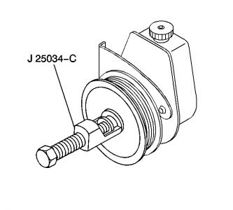

how do you remove the power steering pump?
psp has pulley with allen wrench fitting. how do you lock the pulley and break the bolt loose to get the pulley off?
any other thoughts.
more than happy to donate if you can help me!!
thanks.
Jan 18, 2021 at 1:42 AM (Merged)
DENNYP
  • 1,824 POSTS
Power Steering Pump Replacement (4.3L, 5.0L, 5.7L) Removal Procedure Tools Required J 25034-C Power Steering Pump Pulley Remover Place a drain pan below the pump. Remove the hoses. Cap the hoses. Remove the drive belt. Refer to Drive Belt Replacement in Engine Mechanical 4.3L or Drive Belt Replacement in Engine Mechanical 5.0L and 5.7L. Remove the pulley. Install the J 25034-C . Be sure the pilot bolt bottoms in the pump shaft by turning the nut to the top of the pilot bolt. Hold the pilot bolt. Turn the nut counterclockwise. Remove the front mounting bolts. Remove the rear mounting nuts from the studs. Remove the electrical connector from EVO actuator. Remove the pump. Installation Procedure Tools Required J 25033-C Power Steering Pump Pulley Installer Install the pump. Install the front mounting bolts. Tighten Tighten the bolts to 50 N·m (37 lb ft). Install the rear mounting nuts to the studs. Tighten Tighten the nuts to 50 N·m (37 lb ft). Install the pulley. Place the pulley on the end of the pump shaft. Install the J 25033-C . Be sure the pilot bolt bottoms in the pump shaft by turning the nut to the top of the pilot bolt. Hold the pilot bolt. Turn the nut clockwise. Notice: Do not use an arbor press or internal damage to the pump will result. Connect the pulley to the end of the power steering pump shaft. Install the pulley flush with 0.5 mm (0.020 in) play. Install the drive belt. Refer to Drive Belt Replacement in Engine Mechanical 4.3L or Drive Belt Replacement in Engine Mechanical 5.0L and 5.7L. Install the hoses. Install the electrical connector to the EVO actuator. Fill and bleed the system. Refer to Checking and Adding Power Steering Fluid and Bleeding the Power Steering System . Inspect the hoses and the wiring for clearance.
