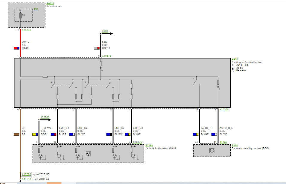

What wire needs 12v and GND to actuate the Parking Brake Control Module?
For reference I found this wiring diagram in thread from last year:
https://www.2carpros.com/images/question_images/449637/original.jpg
Thank you!

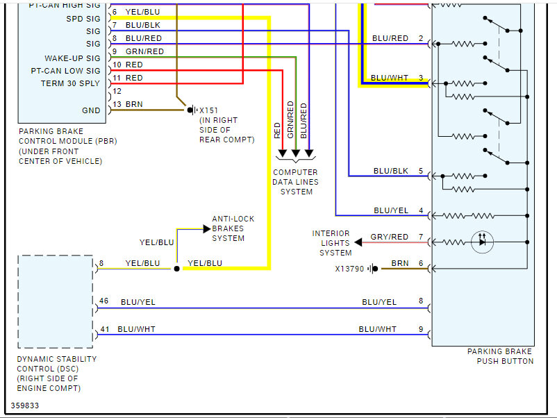

I would be happy to provide a wiring schematic for you, but this procedure should be done using a bidirectional scanner that can actuate the park brakes. My concern is if something becomes damaged.

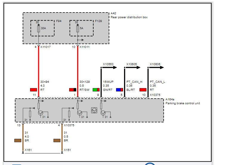

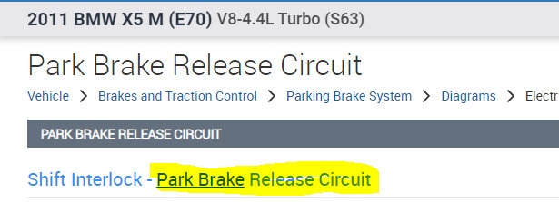

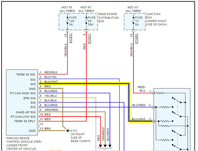

I attached what I have below. Pics two and three are non-OEM and more readable. LOL The remaining is what the manufacturer feels is what we need. Note that I cut the non-OEM pics in half to make it more readable for you. I did overlap them so you can follow from one to the next.
Let me know if this helps.

That should be a 12v signal (B+). If you apply 12v and it seems to run extremely fast, cut the power and drop it to 5v. However, if I recall, it is 12v.
Let me know how things work out for you.
