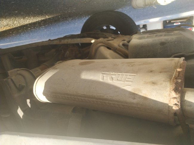

What I'm hearing in the video is a backfire which is likely caused by an exhaust leak. I have a feeling you are correct. I watched the video a couple of times and each time I saw a spot on the corner of the muffler that appeared rusted. It is a split second that I get to see it and can't stop the video fast enough. LOL Check to see if you notice it. It's about 2/3 of the way through your video.

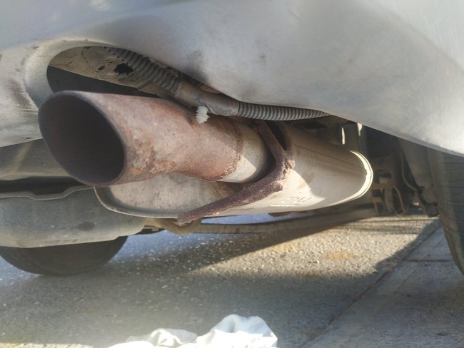

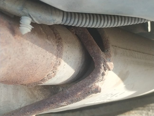

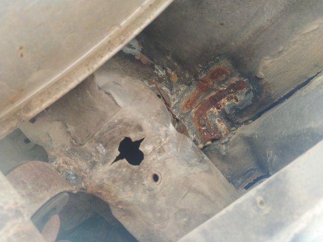

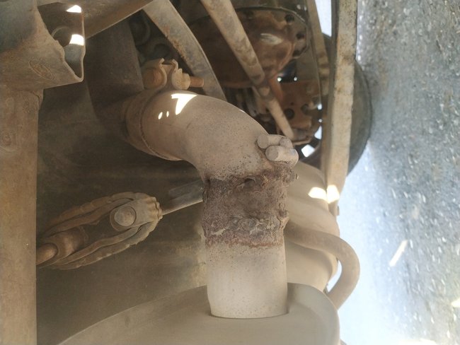

Hi, I couldn't see any visible holes in the muffler, but I did notice some pretty nasty welding with corrosion I don't know if there might be some tiny holes in it. Also, I knew the car was in an accident back in 2014 and someone had "fix it", but taking these pictures now I know it was probably rear ended, hahaha. Look at the hole in my rear chassis.

Is the last pic you attached part of the frame? If so, that should be welded.

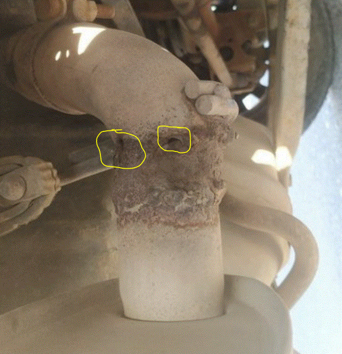

As far as the exhaust is concerned, I copied one of your pics and circled two places I need you to check. They appear to be holes. Also, inspect the exhaust all the way to the engine. There could be an issue at any point causing this.
See pic.

Yes, it's part of the frame, I want to remove the plastic panels so I have more room to look at the damage because I could see lots of rust in the trunk area, but yes, that needs welding.
When I was taking the photos I did saw them but I'll have to test them, I'm thinking with soapy water or dust to see if there's an actual "leak", I'm planning on taking the car next week to a shop so it easier to watch beneath the car, since I want to fix it myself, I mean if I need help I'll get help but that's plan B haha.

If there is a leak there, you will likely feel the exhaust coming from it.

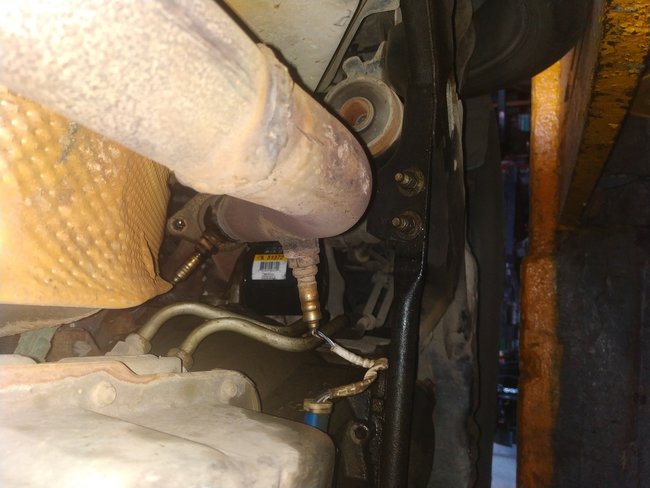

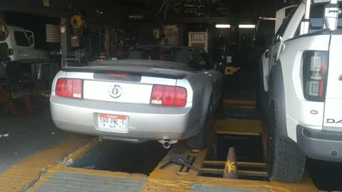

I took the car to the shop and in fact the muffler it's no longer working but guess what Haha someone already cut away both catalytic converters (is that considered a straight pipe?) So, also that's why it was louder than usual, anyways I'm changing the muffler this weekend and I'll be sharing a video of the new sound hopefully that's all it needed.

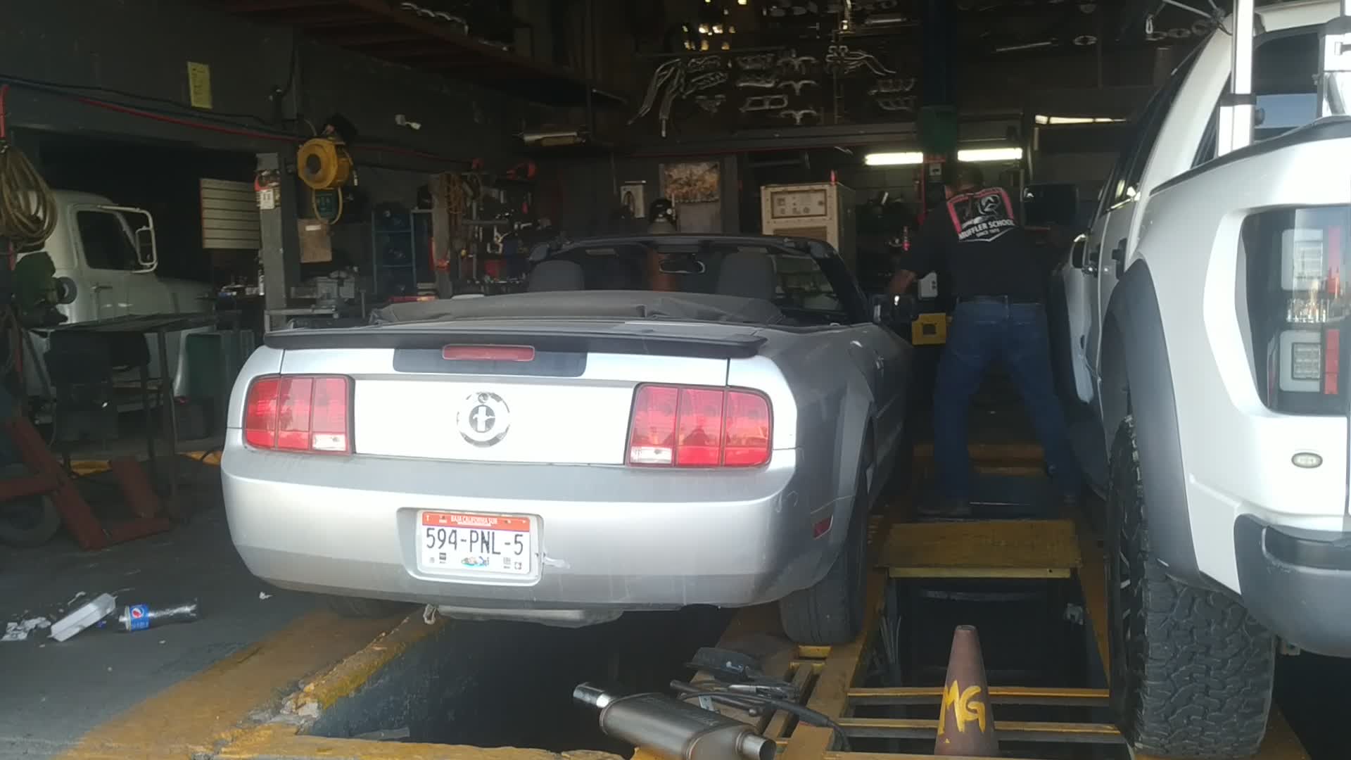

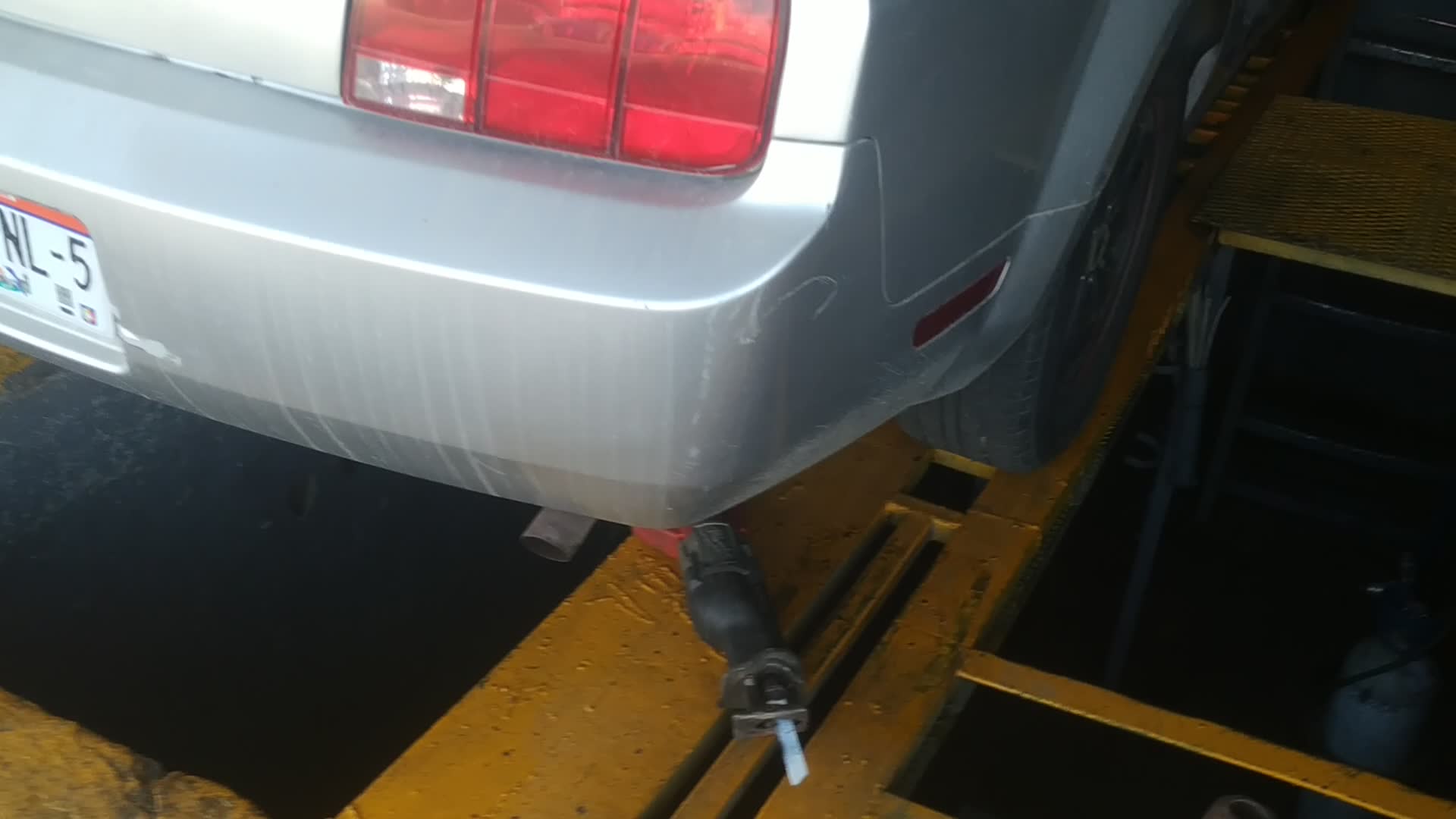

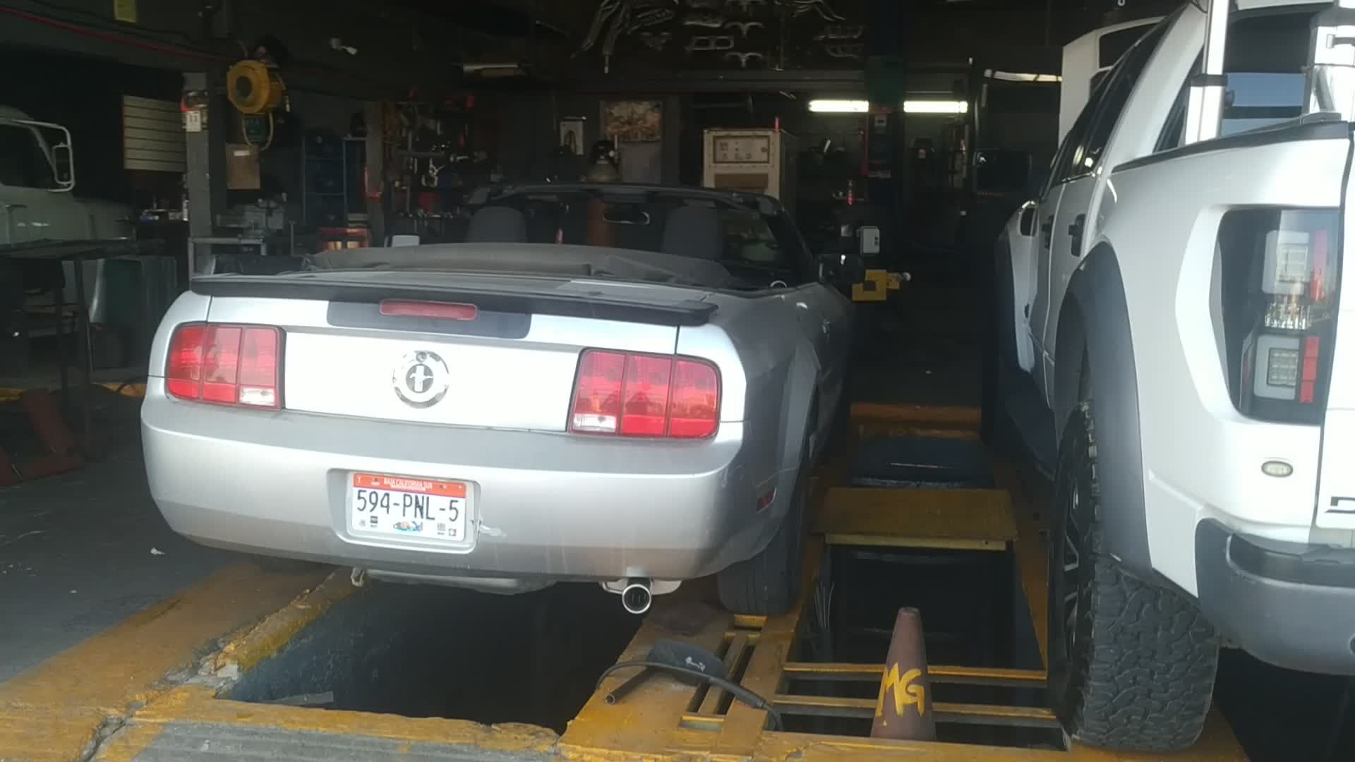

Hi Joe,

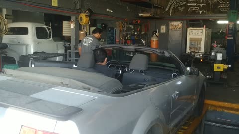

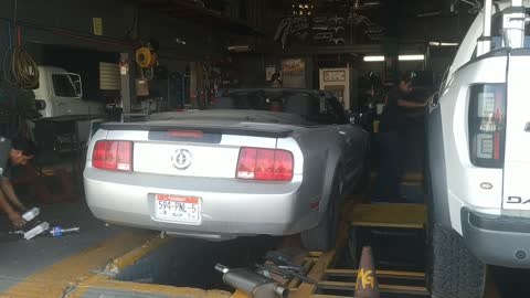

Finally, I was able to take the car to the shop, I have attached some videos with the before and after, now it sounds so good!
I'll take the care to a parts store to check the codes soon enough, haha.
I also attached a photo where the converter was removed.
Cheers!
Adrian
Sunday, May 15th, 2022 AT 4:35 PM

Here I'm attaching a video of how it sounds as a straight pipe; the mic of my phone doesn't do it justice it was quite insane, hahaha.

  • 110,194 POSTS
LOL. It sounds great! I'm glad to know you got things taken care of, and thanks for the update.
