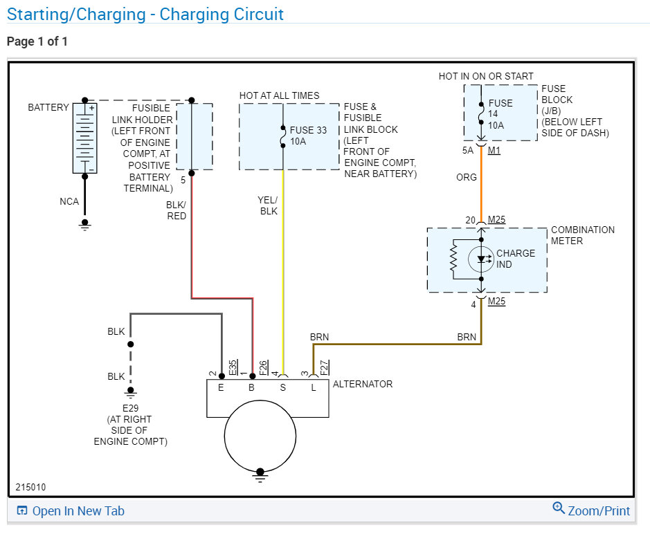

Hooking up the alternator 4 prong harness?
2005 NISSAN MURANO
169,000 MILES • 3.3L • 6 CYL • 2WD • AUTOMATIC
JOHN MYRE
The alternator pigtail has four wires and only the middle two have prongs so what colors do I use from the actual wiring harness for the car to the pigtail wearing harness for the alternator plug? Do you have a color diagram for a the vehicle listed above that is exactly what I need.? I can't find anything that well specific enough.
Mar 27, 2023 at 4:18 AM
  • 54,128 POSTS
Sure, here are the alternator wiring diagrams so you can see how the system works. I have also included a guide on how to check the connections.
Check out the images (below). Please let us know if you need anything else to get the problem fixed.
