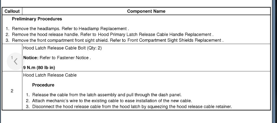

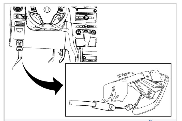

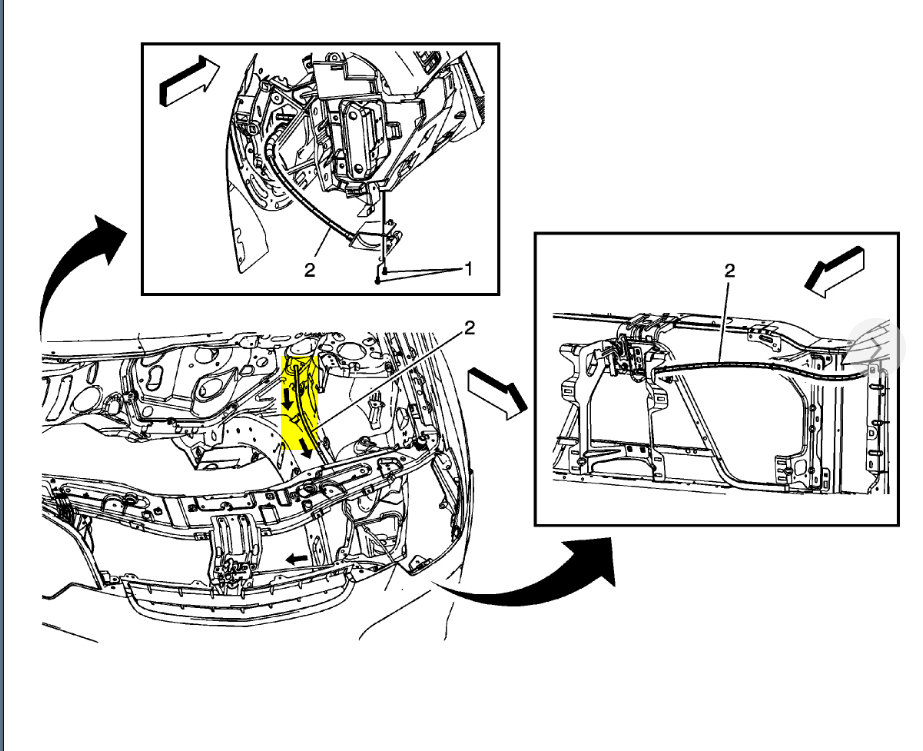

I've got it off but can't locate the hole to thread it back into the engine bay.
Nov 29, 2019 at 12:29 PM

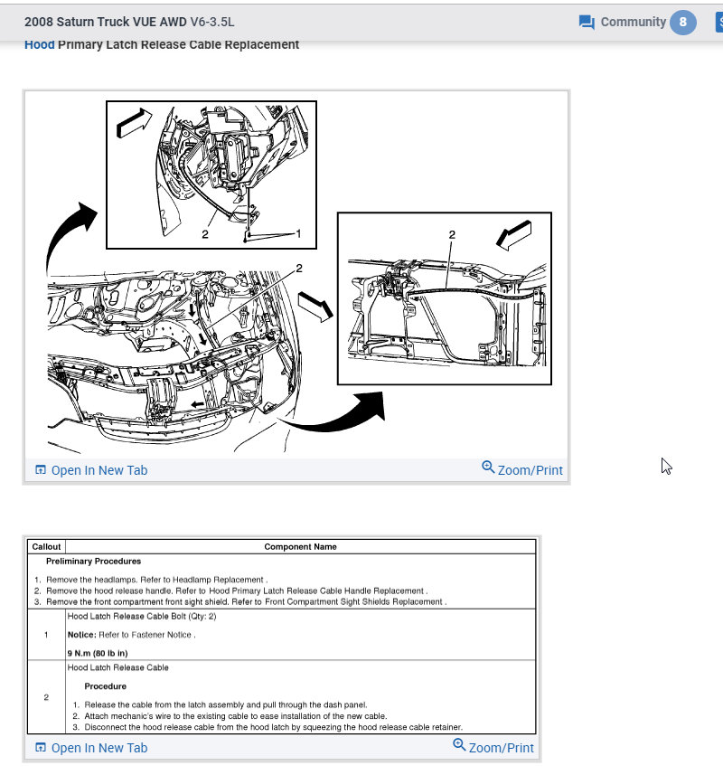

I attached the process but unfortunately it is not the best picture. I would suggest just looking from under the dash and follow where the cable would run and you should be able to find its hole and then just put a screw driver through it or something so you can see if from the engine compartment.
Let me know if you still can't find it and we can try something different.
Nov 29, 2019 at 6:35 PM
BNICOLE
Thanks so much. I swear I've been under the dash and don't see a hole anywhere but I've got some help coming.
Nov 30, 2019 at 1:44 AM
Okay. It may be behind the carpet or even a wiring harness is hiding it.
Let me know if you still can't find it and I will try to find a detailed picture or video. I looked quickly but couldn't find one. Thanks
