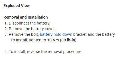

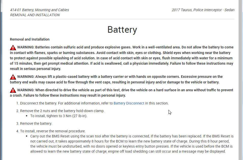

Here are a couple guides that will help step by step instructions on this:
https://www.2carpros.com/articles/how-to-replace-a-car-battery
Here is video of a similar vehicle that will give additional details:
https://www.youtube.com/watch?v=Yb-ytljdCjc
Below is the process from the manual that will give any other details that you may need.
Please run through this material and let us know if you have questions. Thanks

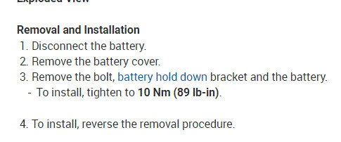

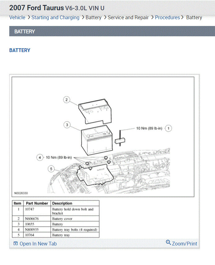

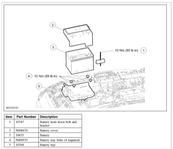

Here is the information you requested. This is a tutorial for you to view on how to replace a battery:
I've attached picture steps below on how to replace the battery on your car. Hope this helps and thanks for using 2CarPros.

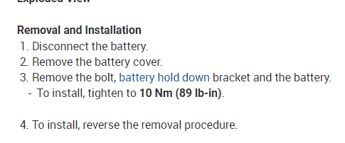

If it is indicating bad, then chances are there is a bad cell in the battery and it does need to be replaced.
Replacing the battery isn't too hard of a job. To get you started, here is a link that explains how in general to replace one. Use this as a guide.
If you look at the attachments below, they include the directions specific to your vehicle for replacement. When you perform this, when disconnecting the battery, start with the negative terminal removal and then the positive. When installing the new battery, start with the positive and then install the negative.
