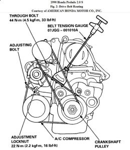

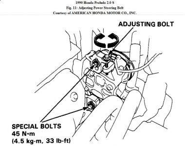

I currently have a 1990 Honda Prelude and when I bot it about 3 weeks ago and i believe the belt was slipping and making a loud squealing noise. I took it to a Honda dealership and they were unable to figure out the problem and I am quite sure the belt is to lose but I do not know which pully it is to tighten both the belts. The Honda dealership was also not able to give me the information I was looking for and was hoping you would be able to help me out.

Hi teddy344, The engine is equipped with 2 belts, the power steering and alternator/AC compressor belt. Each has their own adjustinig points. Depending on which is loose and requires adjustment or replacement. A faulty crank shaft pully ( bad harmonic balancer ) would also cause the belting noise. Here are diagrams of the belt adjustment points.
https://images.2carpros.com/forum/automotive_pictures/192750_BeltAdjustment90PreludeFig02_1.jpg
https://images.2carpros.com/forum/automotive_pictures/192750_BeltPowerSteering90PreludeFig11_1.jpg
