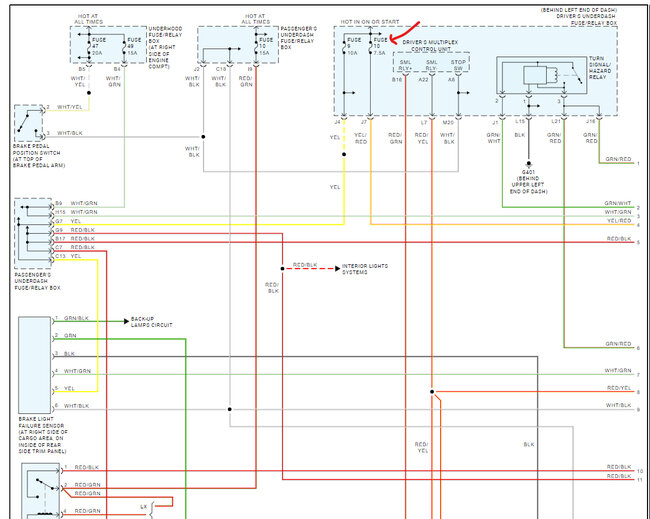

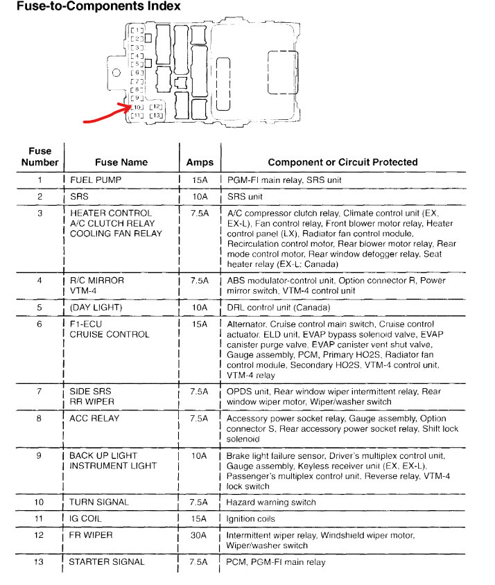

Sep 25, 2024 at 11:10 PM
  • CAR REPAIR CONTRIBUTOR
  • 54,328 POSTS
Sure, here is the fuse in question which is in the fuse panel inside the car on the drivers side. Check out the images (below). Please let us know what happens.
