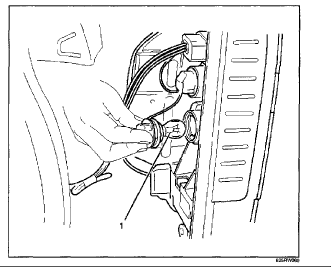

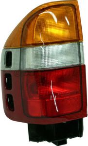

Where will I find the third screw to take out in order to replace the brake light in the rear drivers side? I'm a woman, therefore I'm challenged to begin with, but short of taking the bumper off, I can't find a third screw that is suppose to be between the bumper and the vehicle?

I am sorry Ma'am. . ... I can attach the pics and I even looked up the new part but it doesn't show where the 3 screws are. In one pic they do have a screw driver in one of the holes. If you gently pull, sometimes that will reveal where it is being held.
Also, try stopping by Auto Zone or O'Reilly's, many times the parts folks will not mind showing you where the screws are, you can purchase the bulb while you are there, and sometimes they will do it for you.

Removal
Disconnect the battery ground cable.
https://www.2carpros.com/forum/automotive_pictures/248015_1_33.gif
Remove the rear combination light assembly (1).
Remove three screws.
Pull out the rear combination light assembly toward you.
https://www.2carpros.com/forum/automotive_pictures/248015_2_40.gif
Remove the bulb (1).
Remove the taillight socket by turning it counterclockwise.
Remove the bulb by turning it counterclockwise while pushing it at the same time.
Installation
To install, follow the removal steps in the reverse order.
