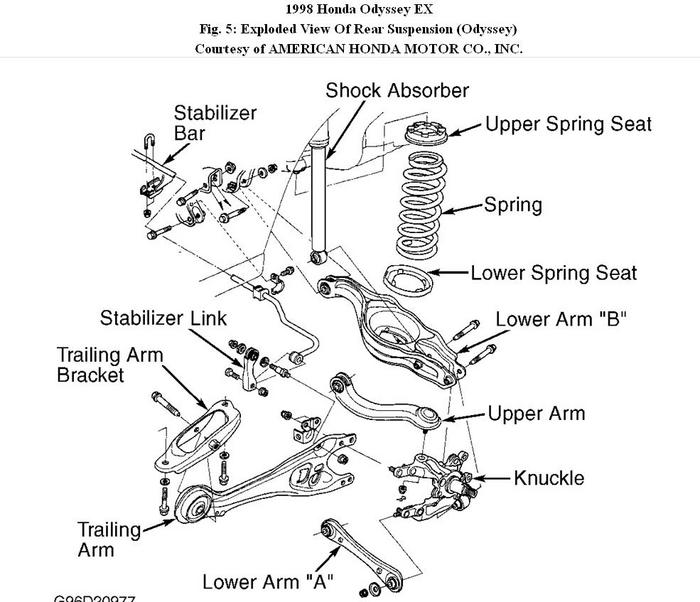

The service department at my dealer says one of my back shocks has a leak. He says it is up to me whether I want just the leaky one replaced or both. What do you recommend?
Wednesday, December 30th, 2020 AT 11:02 AM (Merged)
KHLOW2008
  • 41,814 POSTS
Hi 123car,
Normally shocks should be replaced a set of front or rear. At the mileage shown, the shocks are neither new nor too old so replacing only the faulty pieces is also acceptable.

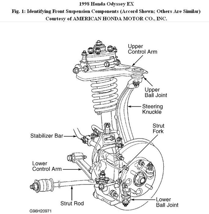

How can I tell if front struts need replacing? My dealer service is telling me I should have it done.
Thank you
John K.
MHPAUTOS
  • 31,937 POSTS
Hi there,
If the strut is oily that is an indication that the top seal has failed, and you can do a bounce test, if the car feels soft and bounces more that 1 11/2 oscillations the struts would be suspect.

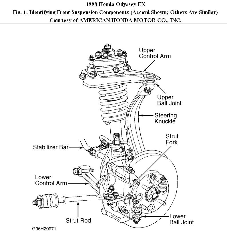

My Honda dealer says the front lower control arm bushing is torn and needs to be repair. First what is the lower control arm bushing? And 2nd, do you recomend that only a Honda technician fixes this problem or can a local mechanic do it as well?
Wednesday, December 30th, 2020 AT 11:03 AM (Merged)
MHPAUTOS
  • 31,937 POSTS
Hi there,
The lower control; arm is the main member that attaches to the bottom of the strut and the sub frame of the car (see Pic) the bush is the pivot at the end of the arm, any qualified mechanic can do this job, it is not that hard.

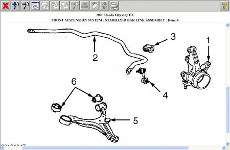

Hello, I took my vehicle to get a tune up and while they were servicing it. They suggested that I replace the sway bar link. My question is, I am able to make general repairs on my vehicle and some other things as I am mechanically incled but I would like to know if with my genral know how would I be avle to replace the sway bar link or would I need a machine shop to snap anything in or can I get away with just the regular racket and socket tools? And if possible could you provide with general instrcutions on how to repalce it without having to take it to the shop?
