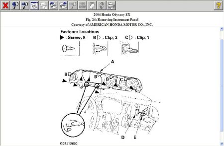

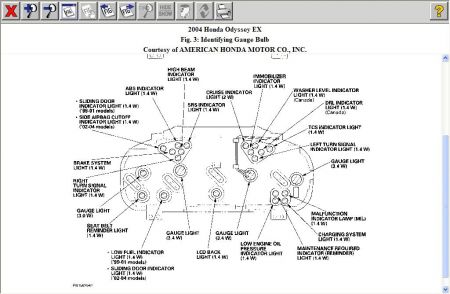

How to change 2004 honda odyssey odometer light bulb?
Thursday, February 19th, 2009 AT 9:41 AM
KHLOW2008
MECHANIC
41,814 POSTS
Hi juanitaharvey,
To replace the LCD back light bulb, you need to remove the instrument panel and meter cluster assy.
