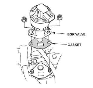

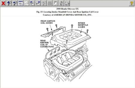

Can someone help me find some instructions on how to clean or replace the EGR valve in a 2000 Odyssey

Hi weatogue, REPAIR PROCEDURE A: EGR VALVE REPLACEMENT 1. Remove the intake manifold cover.

2. Remove the EGR valve.
https://images.2carpros.com/forum/automotive_pictures/192750_EGRValve00Odyssey_2.jpg
3. Install the new gasket and EGR valve. Torque the nuts to 22 N.m (16 lb-ft). Reconnect the EGR valve connector, and install the intake manifold cover.
