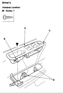

How do I remove the inside door panel on the passenger side

4.Remove the pull pocket panel (A). Take care not to scratch the door panel. 1.Pry out the cap (B), and remove the screw. 2.Release the hook (C), and disconnect the power window switch connectors (D).
https://images.2carpros.com/forum/automotive_pictures/12900_dp4_1.gif
https://images.2carpros.com/forum/automotive_pictures/12900_dp5_1.gif
5.Release the clips that hold the door panel (A) with a commercially available trim pad remover (B), then remove the door panel by pulling it upward. Disconnect the speaker connector (C). For '02-04 models: If equipped with a seat heater, disconnect the seat heater switch subharness connector (D). Remove the door panel with as little bending as possible to avoid creasing or breaking it. 6.Install the door panel in the reverse order of removal, and note these items: *Replace any damaged clips. *Push the clips into place securely. *Make sure the connectors are plugged in properly, and the inner handle rod is connected properly. *For '03-04 models: Reset the power window control unit. *Check the window and power door lock operations. *For '02-04 models: If equipped with a seat heaters, check for proper operation.
