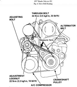

how to remove and replace altenator
Apr 11, 2010 at 2:53 PM
KHLOW2008
  • 41,814 POSTS
Hi autumntilemarble, 1. Ensure you have the radio codes available. 2. Disconnect battery negative terminals. 3. Loosen adjustment locknut. 4. Loosen belt tension by loosening the adjusting bolt. 5. Remove the belt. 6. Remove adjustment locknut. 7. Disconnect wire connector and mains post wire. 8. Remove through bolt. 9. Alternator can be removed. Power steering pump should be loosens and put to side to allow easier access. The hoses need not be disconnected.
