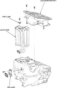

Can you please tell me how to replace the heater core on my 1995 Honda Odyssey? Thanks

Remove mounting bolts and nuts, then steering hanger beam, Fig. 17.
Remove evaporator.
Disconnect connector from mode control motor, then remove mounting bolt and heater unit.
https://www.2carpros.com/forum/automotive_pictures/248015_4_36.jpg
Remove vent/defroster duct, then pipe clamp from heater unit, Fig. 18.
Remove core clamp, then heater core.Do not bend inlet or outlet pipes during heater core removal .
Reverse procedure to install. Do not interchange inlet and outlet heater hoses .
On models equipped with radio coded theft protection system, refer to Vehicle Damage Warnings for system disarming and arming procedures. On models equipped with airbag system, refer to Technician Safety Information for system disarming and arming procedures.
After refilling cooling system, bleed cooling system.

Thank you for the info on replacing heater core on my 95 Honda Odyssey. According to Chilton Manual I just got today, entire dash must be removed before carrying out the steps you provided. Is this true? Thanks. How do I find out my radio's secret code?

I looked in a different manual and according to it, the instrument panel needs to come apart to allow the evaporator unit to come out.
