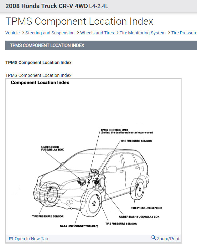

I am about to put new wheels on my car, and I was wondering ow I can reset my TPMS sensor to work with those wheels.

In order to reset the TPMS, you will need the reset tool.
However if you take the sensors off of your current wheels and install them on the new wheels and install them at the same location as the sensor were previously, you will not need to reset the sensor. As far as the sensor is concern everting is as before.
Just be sure to set the tire pressure at the correct level and do not turn on the key during the changing process.
