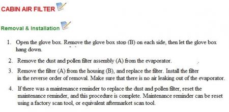

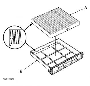

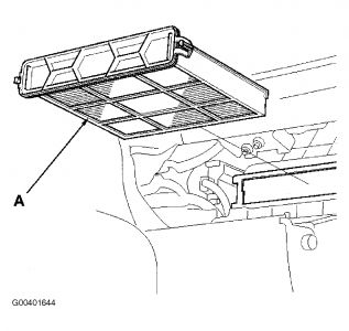

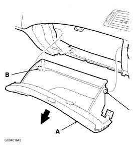

How do I do it?
Thursday, April 29th, 2010 AT 11:20 PM
BLUELIGHTNIN6
MECHANIC
16,542 POSTS
Thursday, April 29th, 2010 AT 11:57 PM
