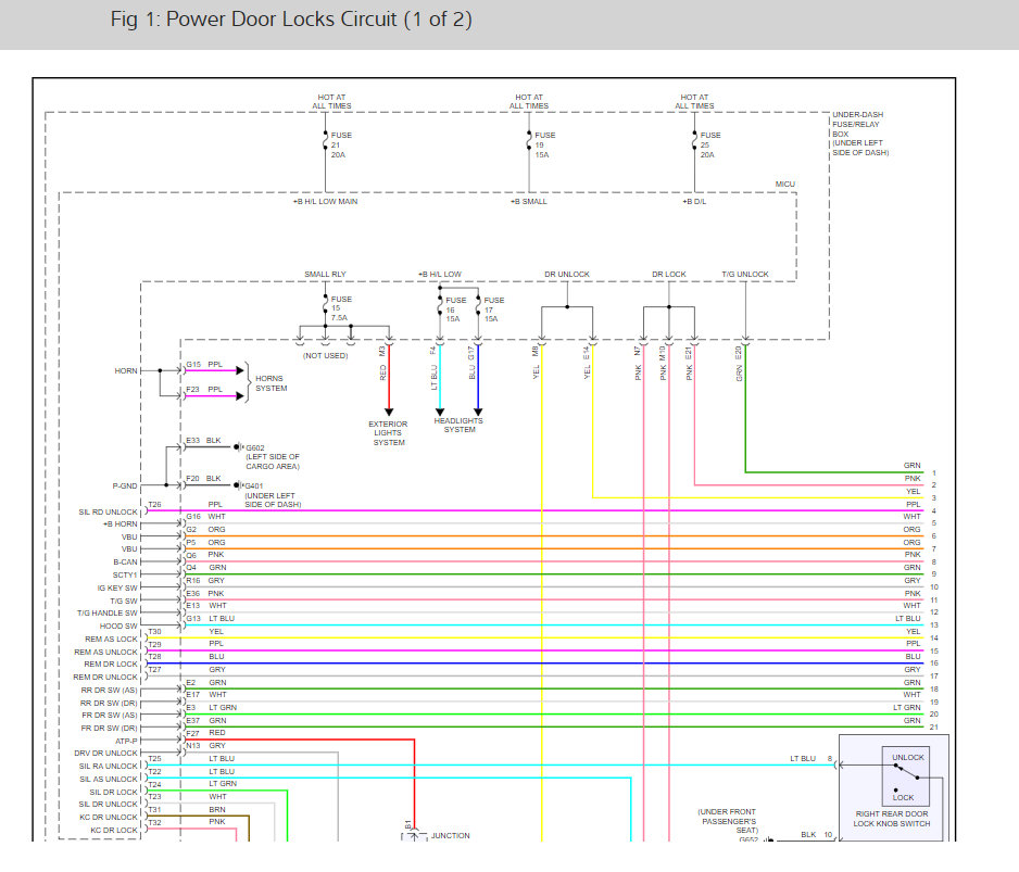

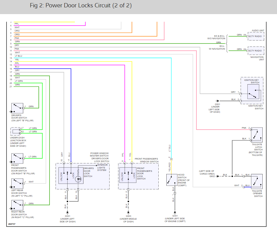

The door lock at the passenger side is not working. The passenger cannot lock the the rest of doors if the driver stepped out from the car. Is there any way I can connect the lock of the passenger door to the central system?
Saturday, April 18th, 2009 AT 1:40 AM

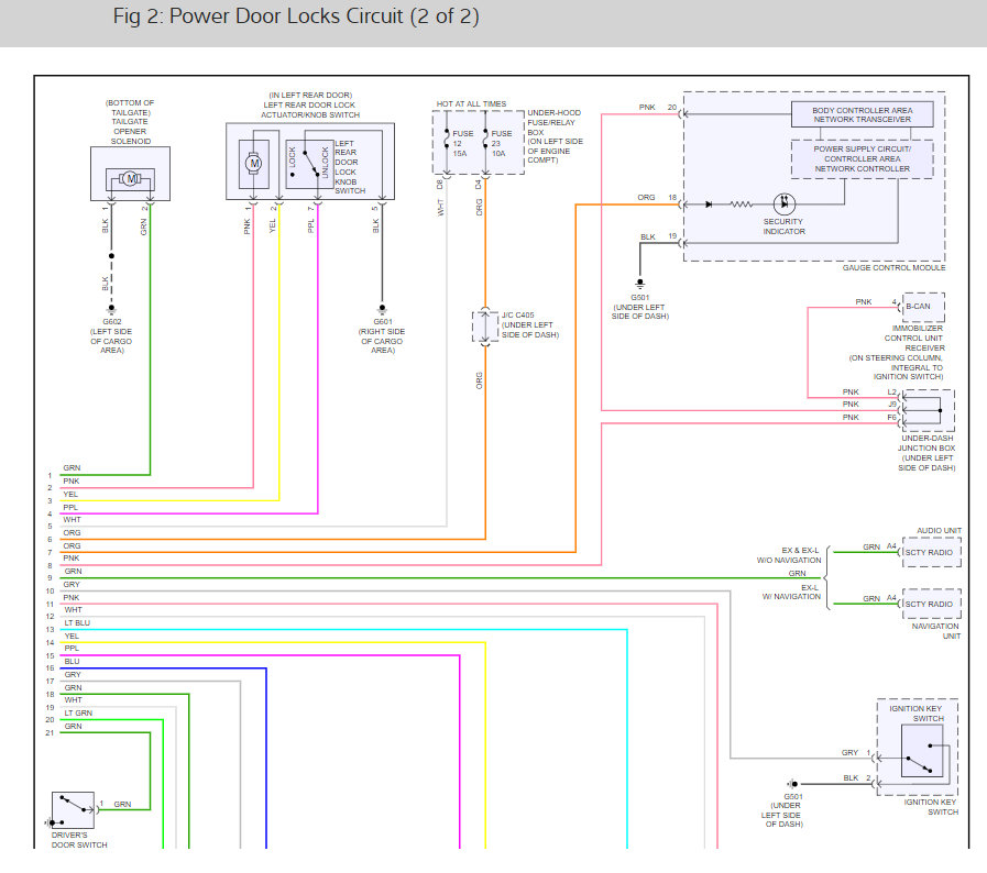

Hi ksaczar,
System is simple, from driver side switch, splice 2 wires and link it to a position where it is easy to access by the passenger side or any other easily accessible position and for the 3rd wire, ground it to body. Switch must be ON-OFF-ON type. It sounds like the door lock actuator is out but tobe sure here is a guide to help test it.
Here is the door lock wiring diagrams so you can see how the system works. Check out the diagrams (Below). Please let us know what you find. We are interested to see what it is.
Wednesday, April 22nd, 2009 AT 2:17 PM
KSACZAR
Thanks a million Kholw,
It was the lock actuator cost me $78.00 for a new one all fixed! I love this site.

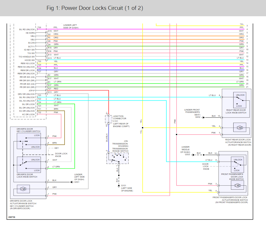

Drivers door lock is stuck u/a to shut door at all. U/a to push down by hand on lock but it will w/ the key only if the door is held open, all other locks work fine by fob & key.

Hi kr8060,
Unless the Driver door latch catches or you need to pull the door opener, if not its lock knob cannot be pushed down. That is the safety feature to prevent accidental locking of door when closing.
If the latch is not catching, you need to repair/replace the latch assy.

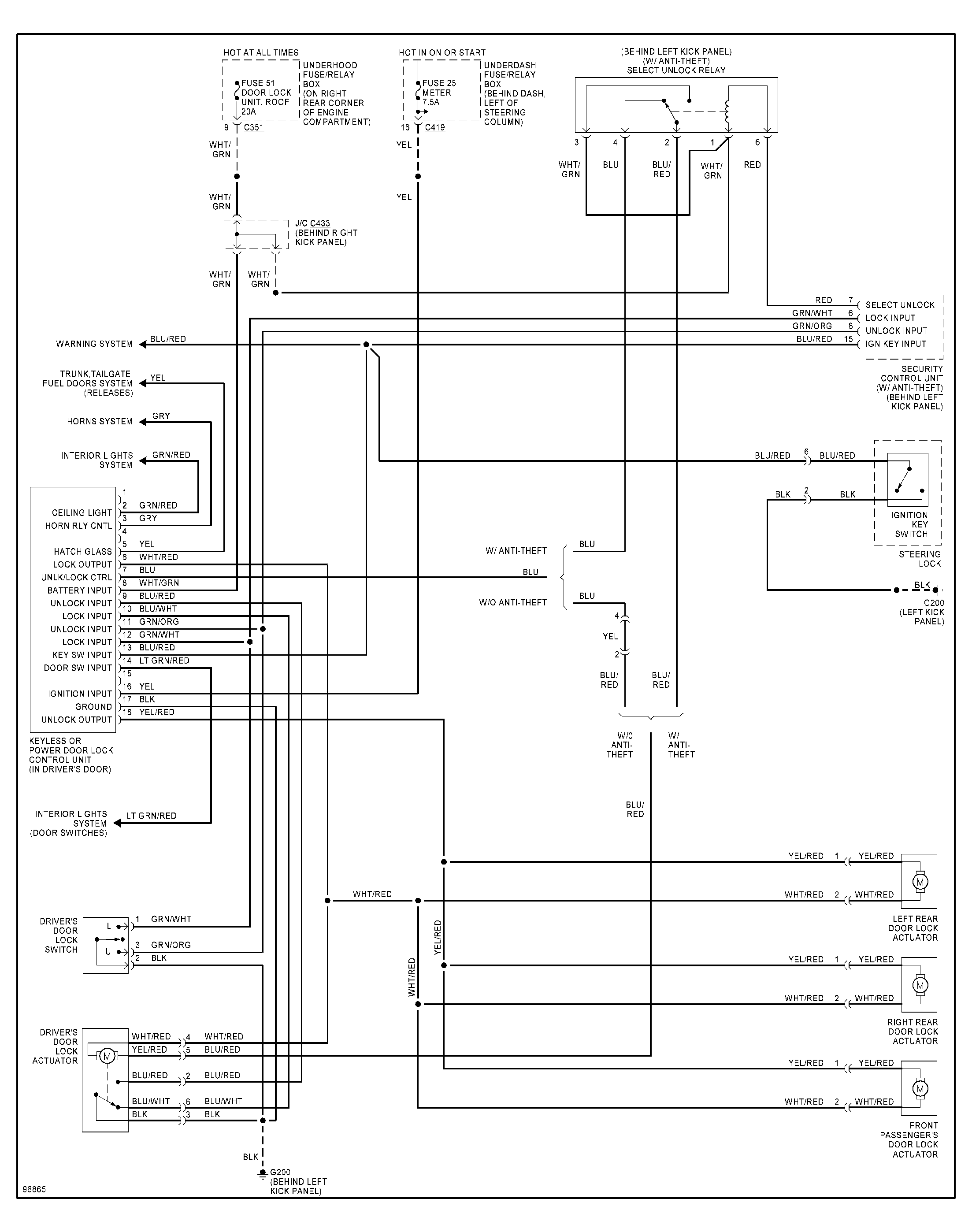

Remote only locks and unlocks driver door

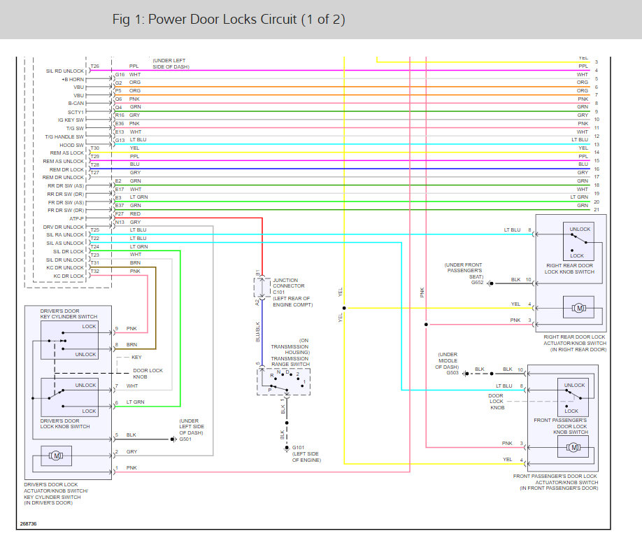

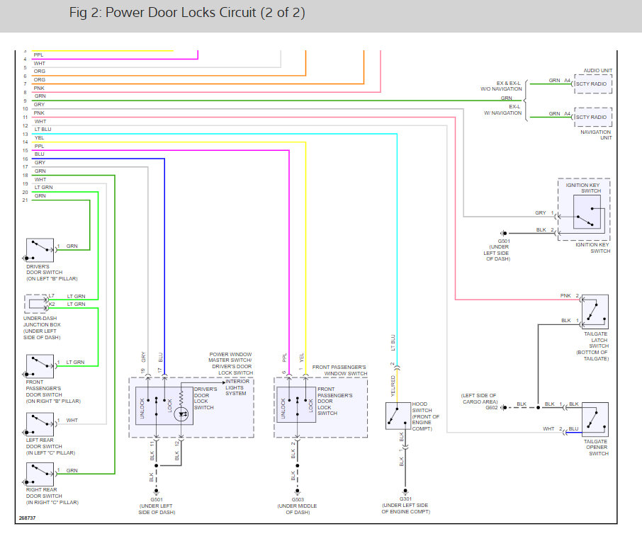

This part here is just a possibility--never tried this---some rigs will let you lock out the windows etc from the driver's controls. Maybe if engaged, it might affect the remote control?
Other than maybe reading the owners manual, I was able to get you a diagram of the system. This might show you something common with the other doorsa relay etc
let me know if you cannot read the diagram
