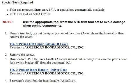

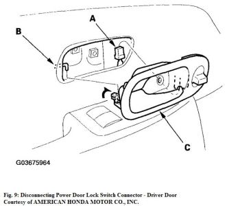

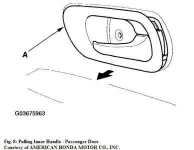

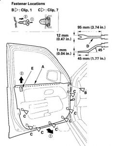

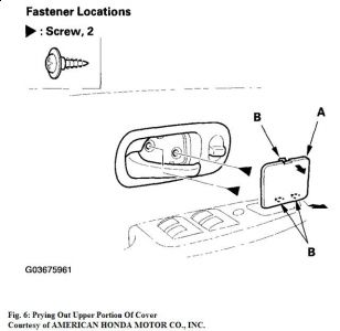

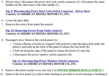

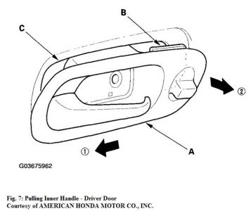

In order to change the passenger mirror you must remove the trim. in order to plug in the three wires for the mirror motor. How do you remove the inside door trim?

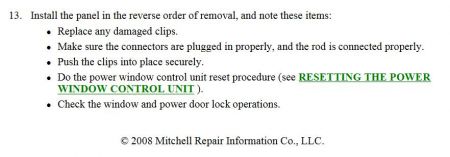

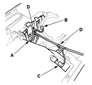

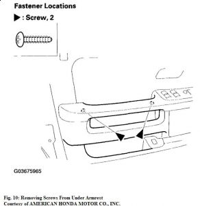

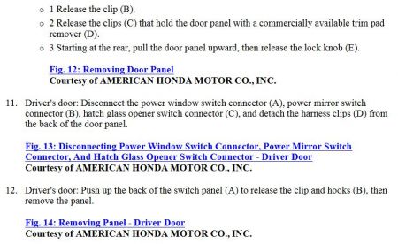

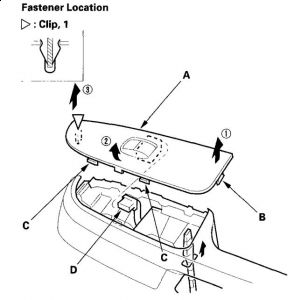

Hi mclaughln, Here are the procedures.
https://images.2carpros.com/forum/automotive_pictures/192750_DoorTrim05CRV01_1.jpg
https://images.2carpros.com/forum/automotive_pictures/192750_DoorTrim05CRV02_1.jpg
https://images.2carpros.com/forum/automotive_pictures/192750_DoorTrim05CRV03_1.jpg
https://images.2carpros.com/forum/automotive_pictures/192750_DoorTrim05CRV04_1.jpg
https://images.2carpros.com/forum/automotive_pictures/192750_DoorTrim05CrvFig6_1.jpg
https://images.2carpros.com/forum/automotive_pictures/192750_DoorTrim05CrvFig7_1.jpg
https://images.2carpros.com/forum/automotive_pictures/192750_DoorTrim05CrvFig8_1.jpg
https://images.2carpros.com/forum/automotive_pictures/192750_DoorTrim05CrvFig9_1.jpg
https://images.2carpros.com/forum/automotive_pictures/192750_DoorTrim05CrvFig10_1.jpg
https://images.2carpros.com/forum/automotive_pictures/192750_DoorTrim05CrvFig11_1.jpg
https://images.2carpros.com/forum/automotive_pictures/192750_DoorTrim05CrvFig12_1.jpg
https://images.2carpros.com/forum/automotive_pictures/192750_DoorTrim05CrvFig13_1.jpg
