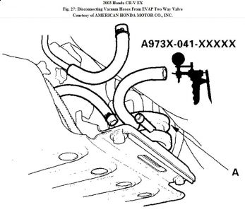

EVAP Bypass Solenoid Valve Test
3 . Disconnect both vacuum hoses from the EVAP two way valve (A), and connect a vacuum pump to the canister port on the EVAP two way valve.
https://www.2carpros.com/forum/automotive_pictures/192750_DTC145603CRVFig27_1.jpg

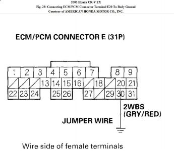

4 . Turn the EVAP bypass solenoid valve ON with the HDS, or connect ECM/PCM connector
terminal E20 to body ground with a jumper wire.
https://www.2carpros.com/forum/automotive_pictures/192750_DTC145603CRVFig28_1.jpg
5 . Turn the ignition switch ON (II).
6 . Apply vacuum to the hose.
Does the valve hold vacuum?
YES - Go to step 7.
NO - Go to step 12.

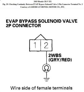

10 . Check for continuity between EVAP bypass solenoid valve 2P connector terminal No. 2 and body ground.
https://www.2carpros.com/forum/automotive_pictures/192750_DTC145603CRVFig29_1.jpg
Is there continuity?
YES - Go to step 11.
NO - Repair open in the wire between the EVAP bypass solenoid valve and the ECM/PCM (E20).

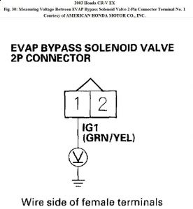

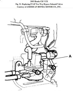

11 . Measure voltage between EVAP bypass solenoid valve 2P connector terminal No. 1 and body ground.
https://www.2carpros.com/forum/automotive_pictures/192750_DTC145603CRVFig30_1.jpg
https://www.2carpros.com/forum/automotive_pictures/192750_DTC145603CRVFig31_1.jpg
Is there battery voltage?
YES - Replace the EVAP two way/bypass solenoid valves (A).
NO - Repair open in the wire between the EVAP bypass solenoid valve and the No. 4 ACG (10A) fuse.

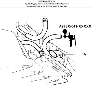

12 . Plug the fuel tank port (A) of the EVAP two way valve.
https://www.2carpros.com/forum/automotive_pictures/192750_DTC145603CRVFig32_1.jpg

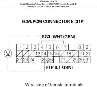

13 . While monitoring FTP sensor voltage with the HDS, or measuring voltage between ECM/PCM connector terminals E4 and E14, slowly pump the vacuum pump once, or until the voltage drops to about 1.5 V.
https://www.2carpros.com/forum/automotive_pictures/192750_DTC145603CRVFig33_1.jpg
Does the voltage drop to 1.5 V and hold for at least 20 seconds?
YES - The EVAP bypass solenoid valve/EVAP two way valve is OK. Go to step 14.
NO - Repair the leakage from the EVAP bypass solenoid valve, EVAP two way valve, or FTP sensor.

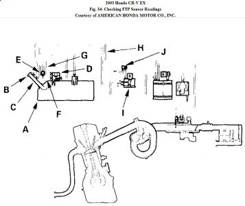

15 . Tighten the fuel cap 3 clicks.
16 . Start the engine, and let it idle for 5 minutes.
17 . Check the FTP sensor readings.
https://www.2carpros.com/forum/automotive_pictures/192750_DTC145603CRVFig34_1.jpg
Is the reading above 0.5 kPa of (4 mmHg, 0.16 in.Hg, 2.8 V) pressure?
YES - Update the ECM/PCM if it does not have the latest software, or substitute a known-good ECM/PCM, then recheck (see ECM/PCM UPDATING AND SUBSTITUTION FOR TESTING ). If the symptom/indication goes away with a known-good ECM/PCM, replace the original ECM/PCM.
NO - Check the following parts for leaks:
"Â Fuel tank (A)
"Â Fuel fill cap (B)
"Â Fuel fill pipe (C)
"Â Fuel tank vapor control valve (D)
"Â Fuel tank vapor recirculation valve (E)
"Â Fuel tank vapor recirculation tube (F)
"Â Fuel tank vapor signal tube (G)
"Â Fuel tank vapor control vent tube (H)
"Â Two way valve (I)
"Â FTP sensor (J)
"Â Fuel tank unit base gasket
Repair or replace any leaking parts.
