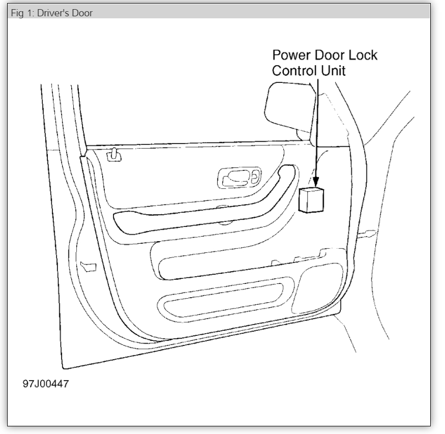

I have check fuses and I change the wireless module and reprogramed the module and still not working.

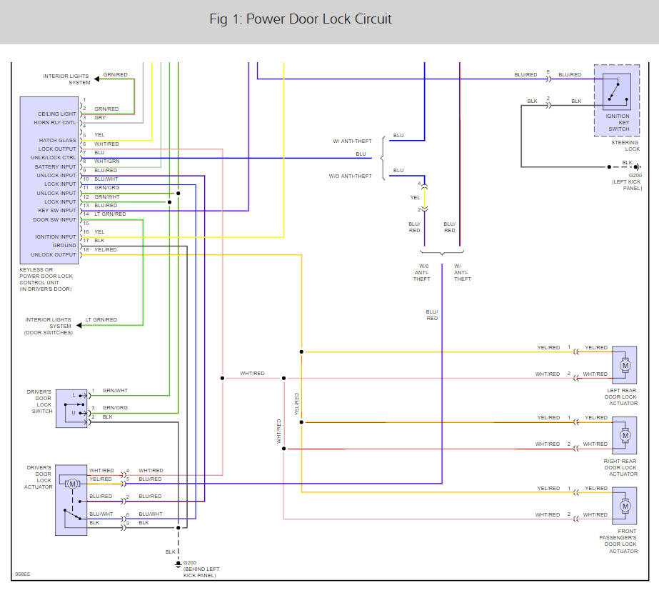

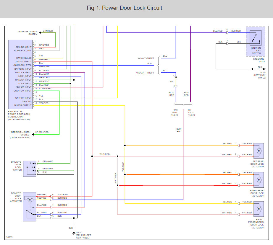

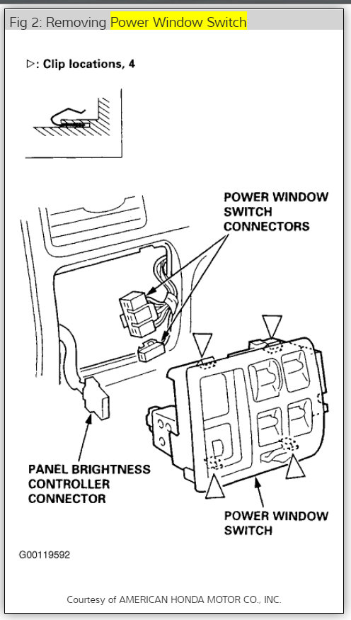

You must be losing ground or power for the system also check the wiring in the driver's door it can get broken where the door hinges are.
Here is a guide and the door lock wiring diagrams (below)
Could be the switch as well
https://www.2carpros.com/articles/electric-window-repair

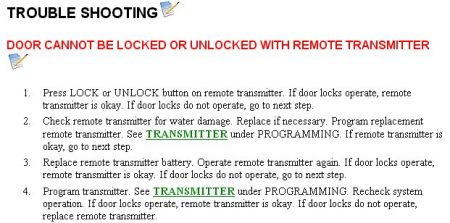

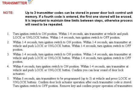

The remote door locks ( key ring ) stopped working.
I replaced the battery in the key fob, with no luck.
I then tried the 2nd remote that ame with the car.
Still nothing happens. I looked at the fuse box and found no problems. Every thing on the car works manualy, locks, horn etc.
Just unresponsive to my remote.

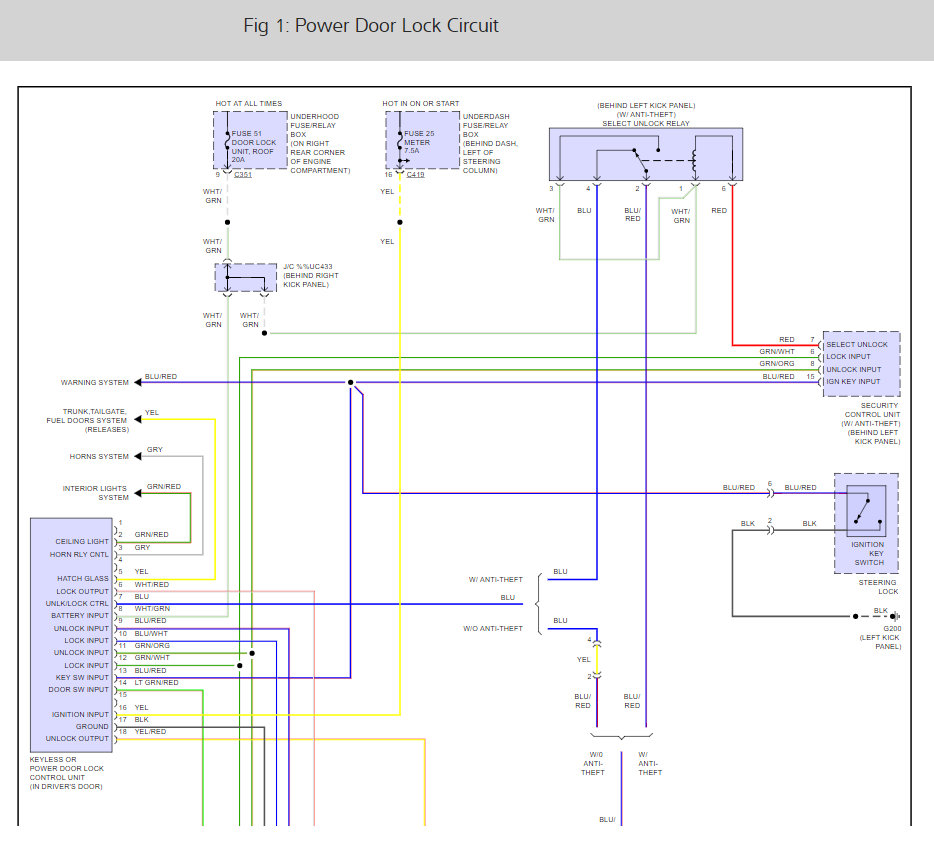

Is there an "receivier" that the remotes trigger, and if so where would you find that little sucker?

https://www.2carpros.com/forum/automotive_pictures/30961_tran_2.jpg
https://www.2carpros.com/forum/automotive_pictures/30961_trans_2.jpg

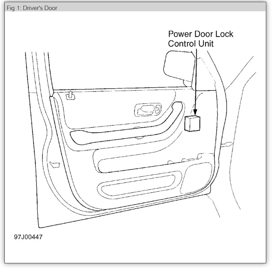

The driver's door does not operate with the power lock. It now only operates with the key. For a time it was intermittent, now it does not work at all. The others doors work electronically. I saw that someone else had the same issue with the same model. What was the answer?

Did you get an answer to your question? I was told that it needs a power lock actuator. Was that the problem?
Wednesday, November 22nd, 2017 AT 5:01 PM (Merged)
KHLOW2008
  • 41,814 POSTS
Hi joekrumm,
You are right, the door lock actuator motor is faulty.
