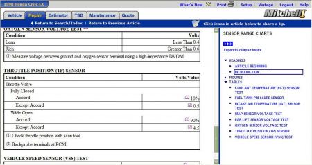

You need a scan tool to adjust the TPS value from closed and opened values to ID a problem with TPS.
In the book it should explain the procedures checking initial voltages in key on engine off. Try doing this first. You might want to check the MAP and CPS sensors.
https://www.2carpros.com/forum/automotive_pictures/12900_Honda_TPS_1.jpg
