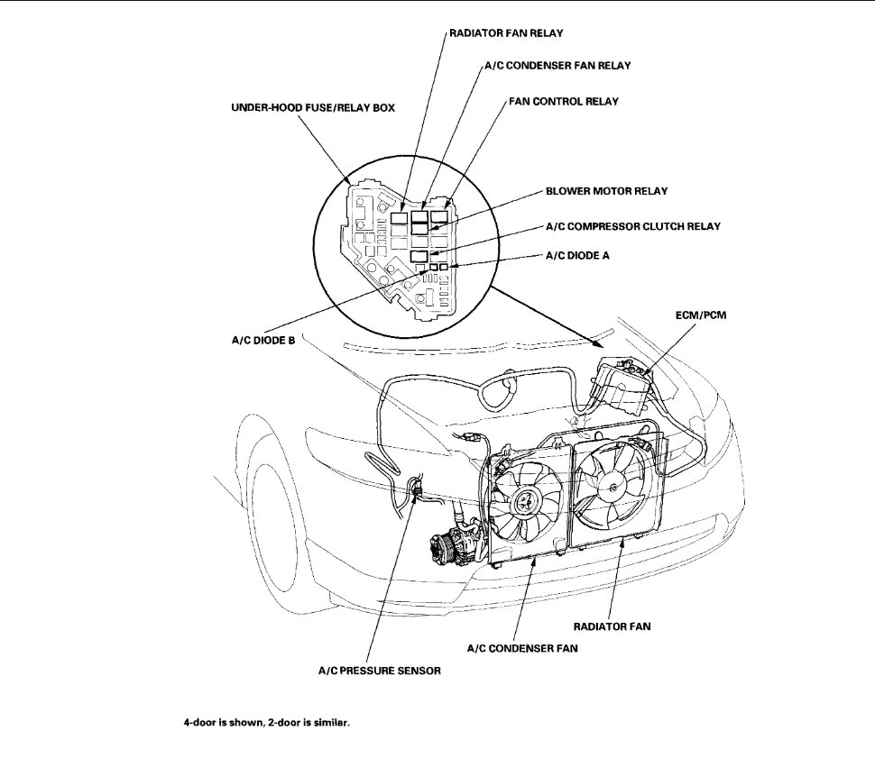

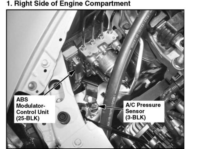

I cant seem to find the low pressure switch on my a/c system, I need to bypass it to ensure my compressor is running before I recharge the system any ideas for it's location

The AC pressure sensor is located on right side of engine compartment near the front of the engine. Check out the diagrams (Below). Please let us know if you need anything else to get the problem fixed.
