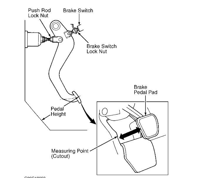

My brakes are stuck when i drive it feels like ive got my foot on the brake.
My garage says that i need new calipers and that a valve has gone. is this correct as i think im being conned into new calipers!
Jan 25, 2010 at 12:00 PM
KHLOW2008
  • 41,814 POSTS
Hi dandandan182,
This happens when the brake booster push rod is adjusted out too far which does no allow the brake master to return fully holding the brakes on . To confirm the issue loosen the brake master mounting bolts 3 turns to see if the car starts to roll again, if so remove the master and adjust the booster push rod inward. Also a brake flex hose can come apart internally causing a short of check valve in the system but this is usually isolated to one brake either front or rear. It is possible the calipers are sticking due to the pistons seizing. Whether servicing of the calipers or replacement is required would depend on the piston condition. Did this occur only after repairs of the brake system or replacement of the brake pads?
Jan 29, 2010 at 11:46 AM
DANDANDAN182
Thank you for your reply!
Its was my booster rod adjustment, wond it in 2 turns the brakes work great

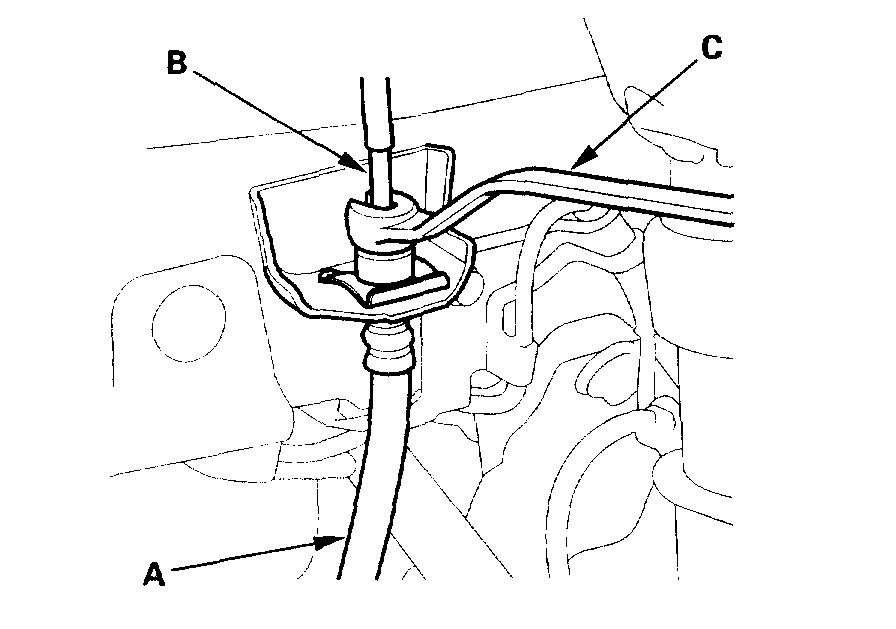

If you open the bleeder and the brakes release, it sounds like the rubber brake hose to the caliper is bad. What happens is internally they break down. As a result, with the pressure of your foot, you can force fluid into the caliper. However, when you release the pedal, the caliper isn't strong enough to push the fluid back. As a result, the brake locks up or drags.
Am I correct in assuming when you open the bleeder, the brake releases? If so, replace that hose.
Here are the directions. The attached pics correlate with the directions.
___________________________________________________
2005 Honda Civic L4-1.7L SOHC
Procedures
Vehicle Brakes and Traction Control Hydraulic System Brake Hose/Line Service and Repair Procedures
PROCEDURES
Brake Hose Replacement
NOTE:
^ Before reassembling, check that all parts are free of dust and other foreign particles.
^ Replace parts with new ones whenever specified to do so.
^ Do not spill brake fluid on the vehicle; it may damage the paint; if brake fluid gets on the paint, wash it off immediately with water.
^ To prevent dripping, cover disconnected line joints with rags or shop towels.
pic 1
1. Replace the brake hose (A) if the hose is twisted, cracked, or if it leaks.
2. Disconnect the brake hose from the brake line (B) using a 10 mm flare-nut wrench (C).

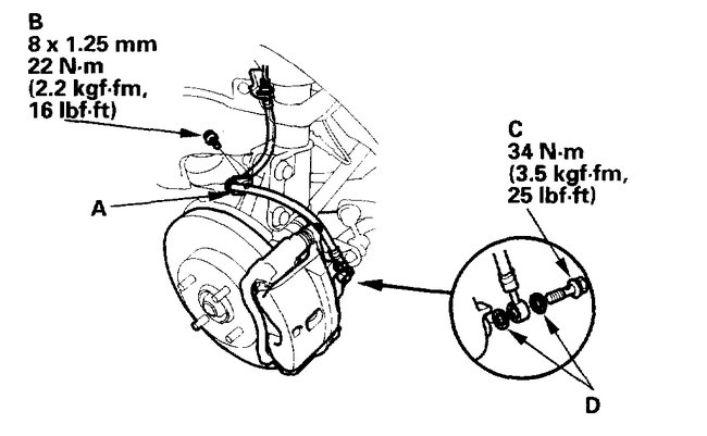

pic 2
3. Remove the flange bolt (A), and remove the brake hose brackets from the damper.
4. Remove and discard the hose clip (B).
5. Remove the banjo bolt (C), and remove the brake hose from the caliper.

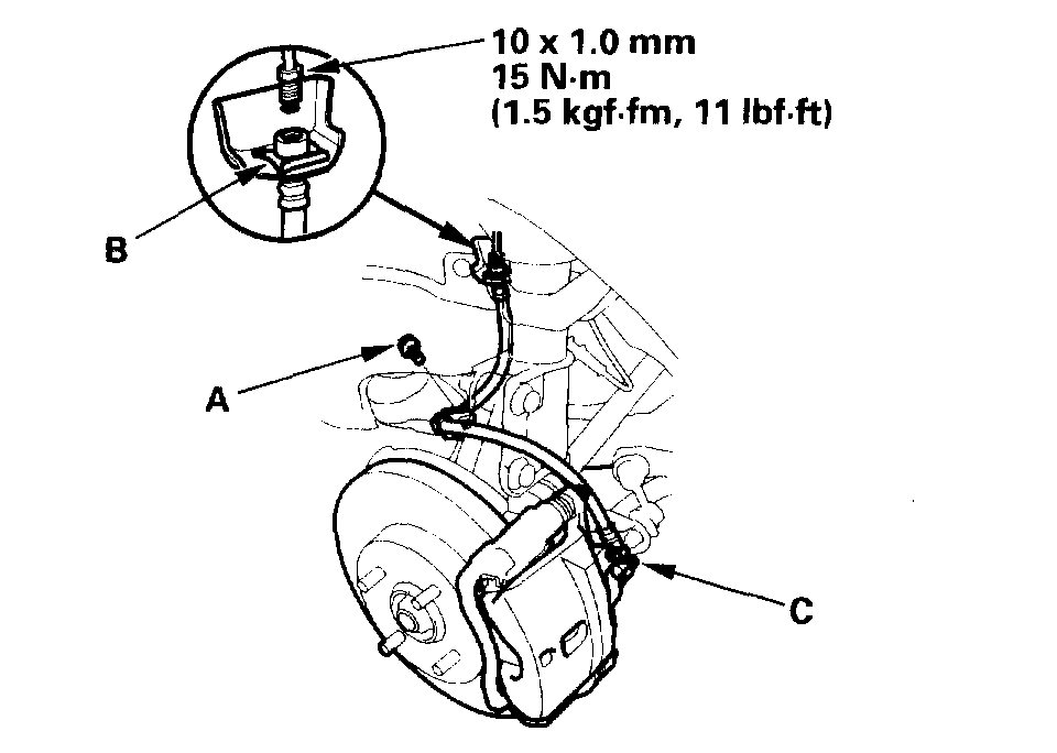

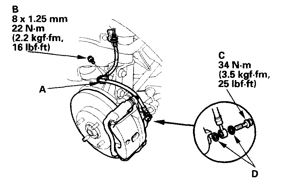

pic 3
6. Install the brake hose bracket (A) on the damper with the flange bolt (B) first, then connect the brake hose to the caliper with the banjo bolt (C) and new sealing washers (D).

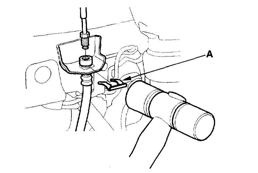

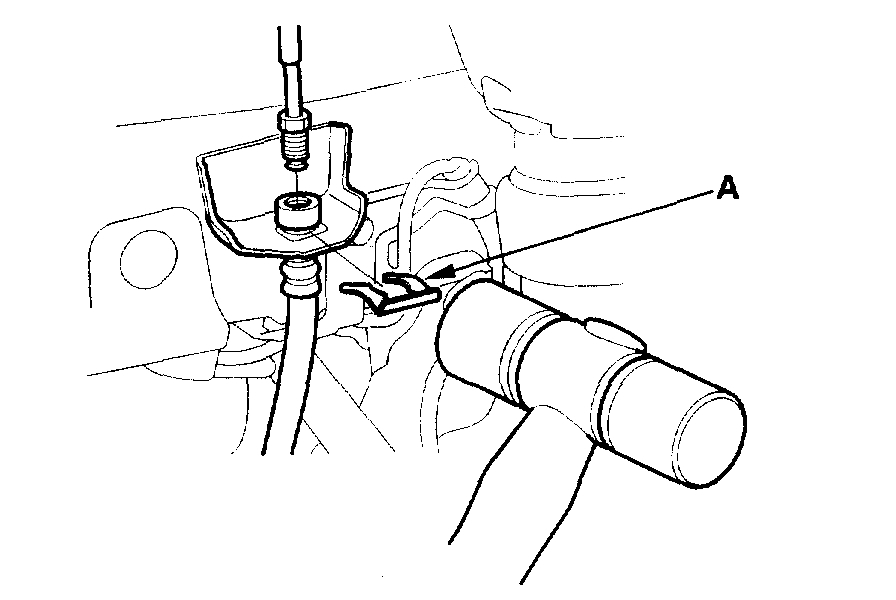

pic 4
7. Install the hose onto the hose bracket on the body with a new hose clip (A).
8. Connect the brake line to the brake hose.
9. After installing the brake hose, bleed the brake system.

the brake pedal has normal travel when car started. As the brake pedal is pushed a few times, there is less and less travel before the brakes engage. Then the brakes drag and eventually lock preventing the car from rolling. Front disks are hot, the rear drums are not.
Recently replaced the plastic plug in the brake pedal that the brake light switch engages. Did not tough any of the brake adjustments. Don't see how this would affect it, but it did start happening soon after.
Mar 16, 2021 at 12:12 PM (Merged)
So we can assume that the issue is with the front brakes locking up as they are hot. However, we cannot assume it is both front since the brakes will get hot when used so we need to lift the vehicle and pump the brakes to get them to lock and up then spin each wheel to see which are locked up.
This could be a couple things but the first and foremost are the master cylinder, calipers, or the rubber brake lines are swelling not allowing the caliper to release.
Let's lift the vehicle and find out which specific wheels this is and we can go from there. Thanks
CRWOFF
It turned out that it was the brake light switch. When I reinstalled it, it was too far in towards the pedal. The brake pedal could not return all the way. Apparently this causes problems in the master cylinder.
The test was that i removed the switch and all the braking problems went away. None of the literature or manuals I found mentioned that it could be adjusted.
Thanks for your help!

you may have to shorten the pedal to the master cylinder as it may not be coming back all the way. see pic brake pedal height must be 6.34inches. Check out the diagrams (Below). Please let us know if you need anything else to get the problem fixed.

Sounds like the adjustment rod between the master and booster is mis-adjusted. This will cause the front brakes to "drag", without even touching the brake pedal, and burn them up.

If both front brakes are locking up, check the adjustment of the brake light switch to be sure it is not holding the brake pedal down a little. If only one is getting hot, stop on a slight incline, place the transmission in "neutral", place a block about a foot downhill of one tire, then open the hydraulic system in various places to see what makes that brake release. You can start at the steel line at the master cylinder, or with the bleeder screw on that caliper. Once we know what you can open and the brake does not release, we can figure out what is causing the restriction and blocking the fluid from releasing back to the master cylinder.
