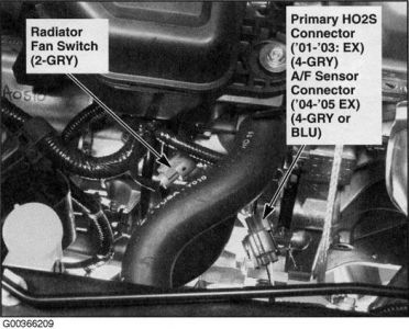

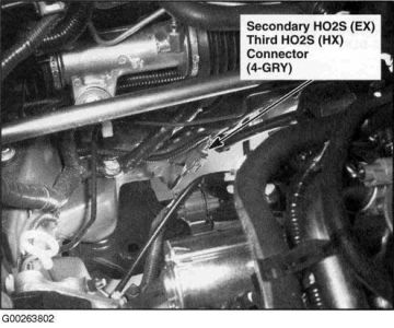

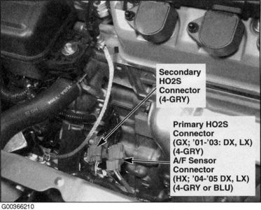

locate ho2 senser
Nov 25, 2008 at 2:52 PM
ZACKMAN
  • 4,202 POSTS
EX model
https://images.2carpros.com/forum/automotive_pictures/55316_civicexprimo2_1.jpg
https://images.2carpros.com/forum/automotive_pictures/55316_civicex2ndo2_1.jpg
LX model
https://images.2carpros.com/forum/automotive_pictures/55316_civiclxprimo2_1.jpg
