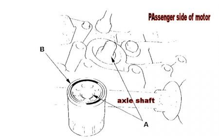

I cant find the oil filter. I want to change the oil and the filter.

It might be easier to pluu the right front wheel, you be the jusdge when you find it.
IT is on the engine on the firewall side. Look above the axle shaft. When you get the filter off. MAke sure the back seal comes off with it.
