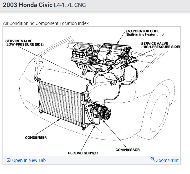

I am trying to locate the low side of the A/C to recharge the A/C. Could you tell me were this is located?

The low side port is on top with the low side hose. Check out the diagrams (Below). Please let us know if you need anything else to get the problem fixed..............................................................
