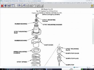

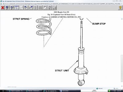

Do the rear struts have replaceable cartridges?
Friday, April 4th, 2008 AT 11:59 AM
MERLIN2021
MECHANIC
17,250 POSTS
No it's more like a large shock that all the hardware goes on...as seen here..
