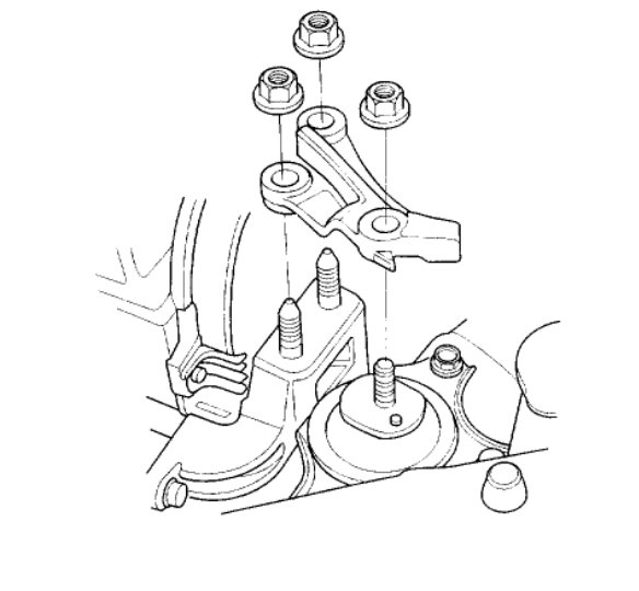

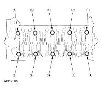

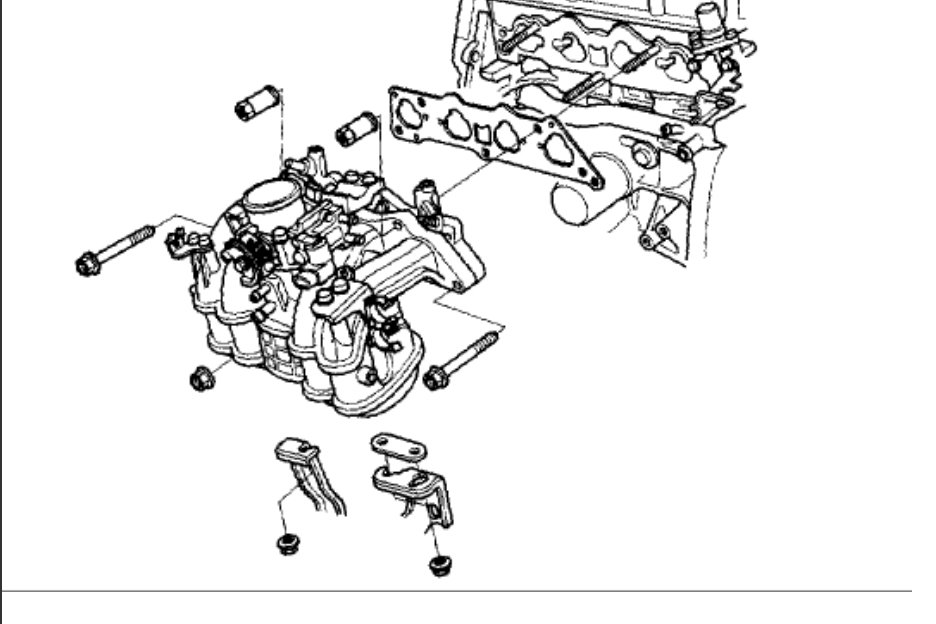

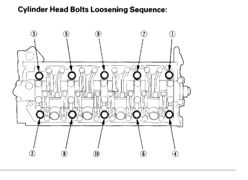

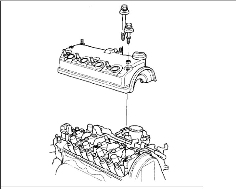

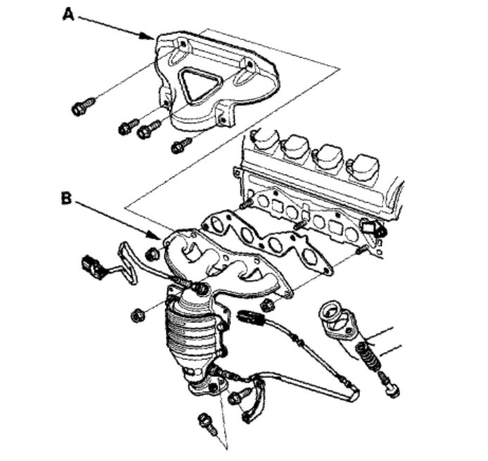

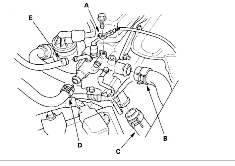

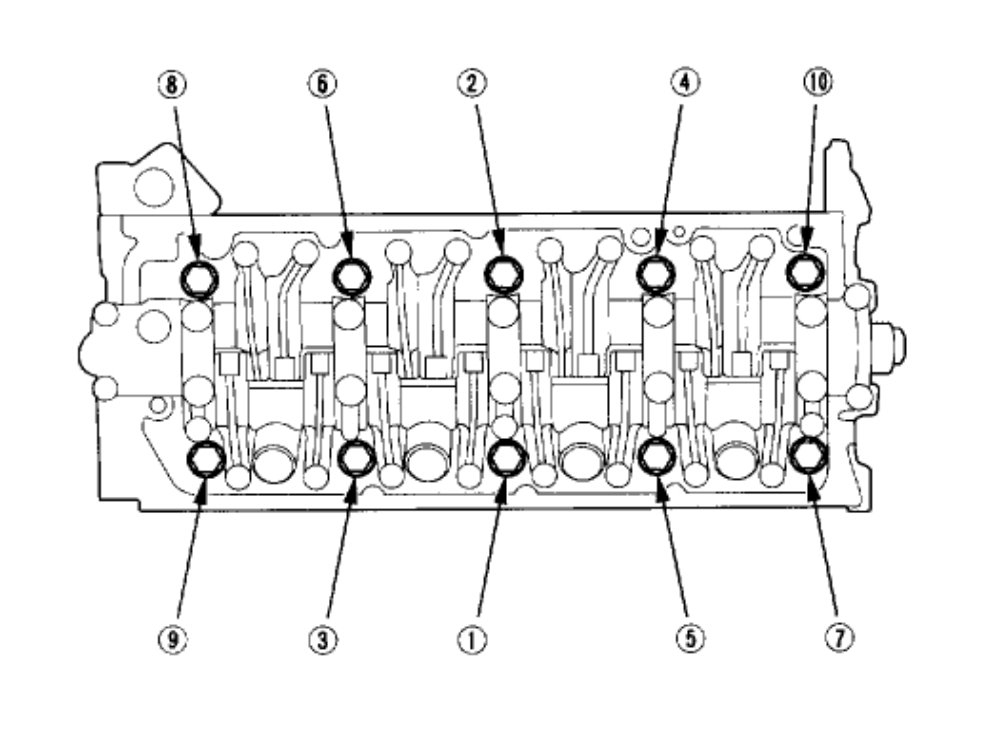

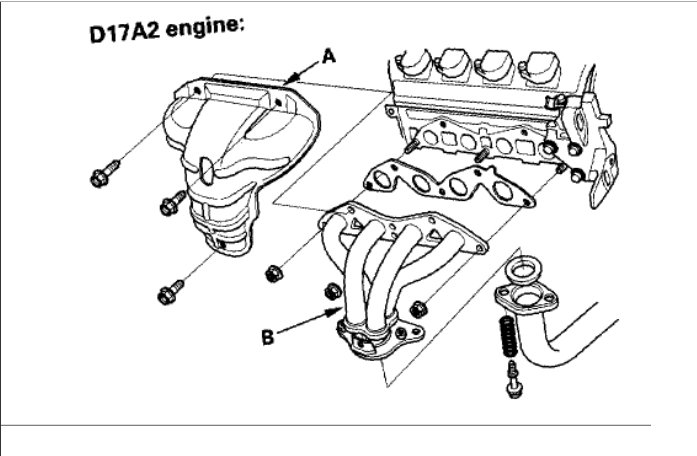

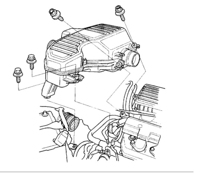

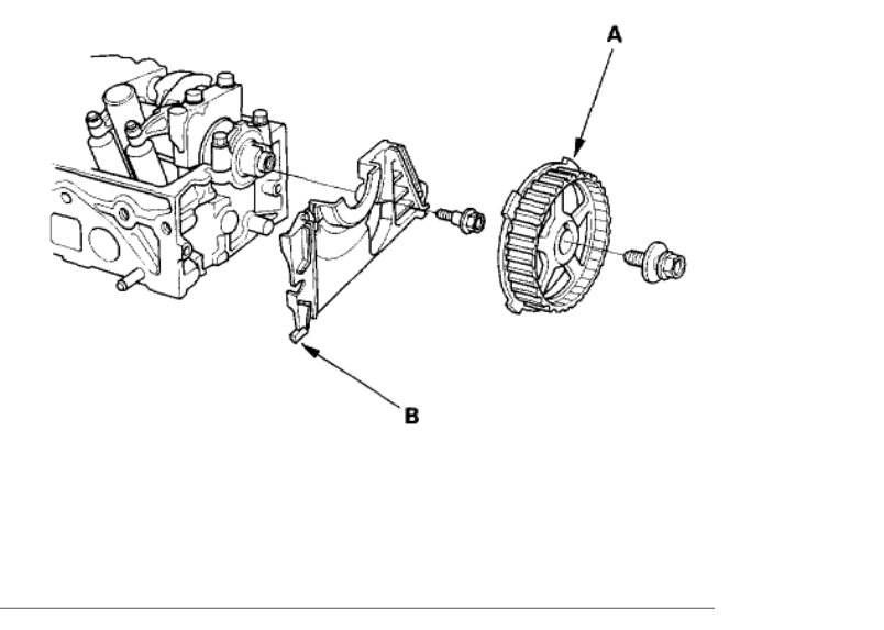

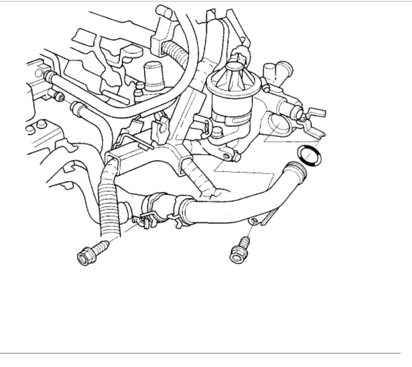

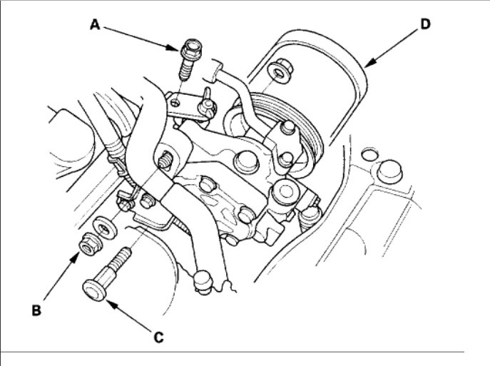

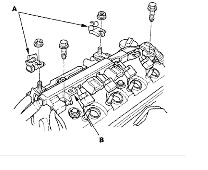

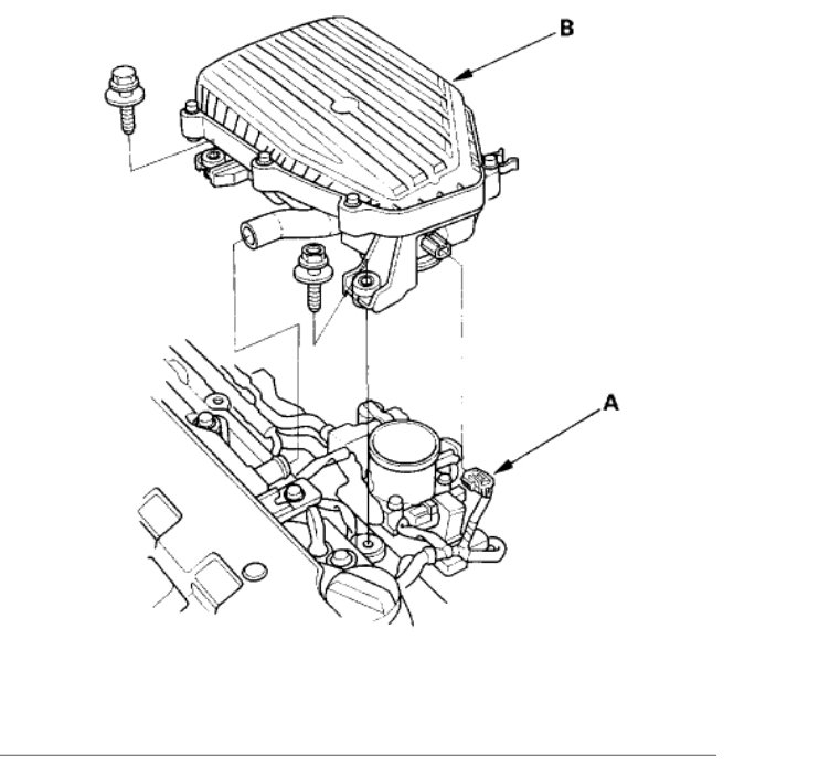

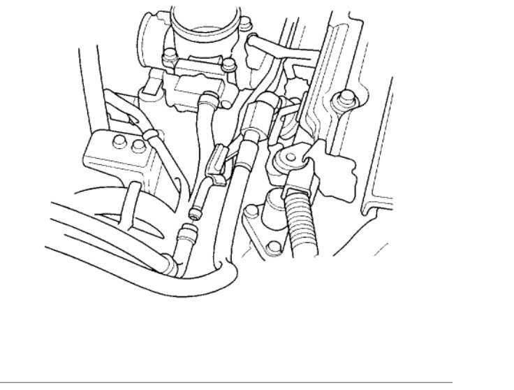

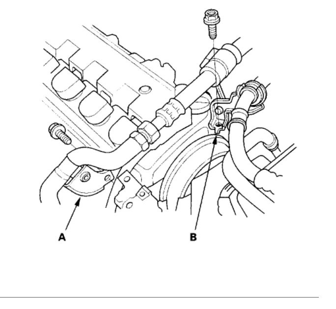

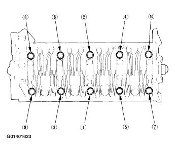

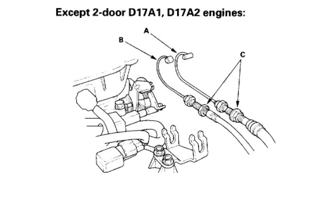

Four cylinder front wheel drive automatic. I am doing a head gasket repair on my EX model and I wanted to know the bolt sequence on taking the head bolts off and putting them back on. I also need the torque specs on the bolts? Thanks.

https://images.2carpros.com/forum/automotive_pictures/261618_Noname2_448.jpg
https://images.2carpros.com/forum/automotive_pictures/261618_Graphic_287.jpg
https://images.2carpros.com/forum/automotive_pictures/261618_Noname_1509.jpg
https://images.2carpros.com/forum/automotive_pictures/261618_install_2.jpg

Here is the torque again
Tighten the cylinder head bolts sequentially in 3 steps.
1st step torque: 20 Nm (2.0 kgf-cm, 14 ft. lbs.)
2nd step torque: 49 Nm (5.0 kgf-cm, 36 ft. lbs.)
3rd step torque: 67 Nm (6.8 kgf-cm, 49 ft. lbs.)
Larger view (below) of every step to do a head gasket on this car.
