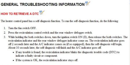

The a/c fan does not come on in the car
i removed fan under pas side fan is good
runs when power put to it
rep fan relay under hood did not fix prob.

I had no idea that this can be done... we learn something every day, try this...

I will try this thank u I will let u know it does
