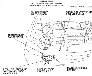

Four cylinder front wheel drive automatic 123,000 miles.
Where is the TCC solenoid valve and how do you test it? I am getting code P1735, drive letter D is blinking and transmission does not engage when starting from a stop.

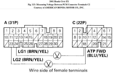

DTC P1753: PROBLEM IN TORQUE CONVERTER CLUTCH SOLENOID VALVE CIRCUIT (2001 -03 MODELS) NOTE: "¢ Record all freeze data and review General Troubleshooting Information before you troubleshoot. "¢ This code is caused by an electrical circuit problem and cannot be caused by a mechanical problem in the transmission. 1 . Turn the ignition switch OFF. 2 . Disconnect PCM connectors A (31P) and C (22P). 3 . Turn the ignition switch ON (II). 4 . Measure the voltage between PCM connector terminals C2 and A23 or A24.
https://images.2carpros.com/forum/automotive_pictures/192750_P1753_01CivicFig113_1.jpg

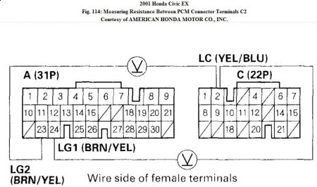

Is there voltage? YES - Repair short to power in the wire between PCM connector terminal C2 and the torque converter clutch solenoid valve. NO - Go to step 5. 5 . Turn the ignition switch OFF. 6 . Measure the resistance between PCM connector terminals C2 and A23 or A24.
https://images.2carpros.com/forum/automotive_pictures/192750_P1753_01CivicFig114_1.jpg

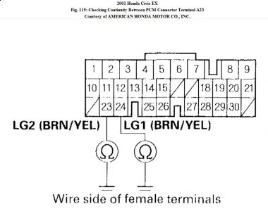

Is the resistance 12-25 ohm ? YES - Check for loose terminal fit, and repair if necessary. Update the PCM if it does not have the latest software, or substitute a known-good PCM then recheck. If the symptom/indication goes away with a known-good PCM, replace the original PCM. NO - Go to step 7. 7 . Check for continuity between PCM connector terminal A23 and body ground, and between terminal A24 and body ground.
https://images.2carpros.com/forum/automotive_pictures/192750_P1753_01CivicFig115_1.jpg
Is there continuity? YES - Go to step 8. NO - Repair open in the wires between PCM connector terminals A23, A24, and ground (G101), or repair poor ground (G101). 8 . Disconnect torque converter clutch solenoid valve connector (2P). 9 . Check for continuity between PCM connector terminals C2 and A23 or A24.

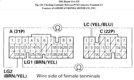

https://images.2carpros.com/forum/automotive_pictures/192750_P1753_01CivicFig116_1.jpg
Is there continuity? YES - Repair short to ground in the wire between PCM connector terminal C2 and the torque converter clutch solenoid valve. NO - Go to step 10. 10 . Measure torque converter clutch solenoid valve resistance at the solenoid valve connector.

After looking through transmission repair manuals at library, I located the torque converter solenoid plug. The plug was underneath the radiator hose and I had not plugged it in after re-installing transmission. Everything works fine now.

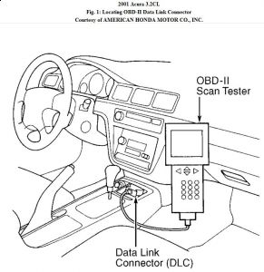

Could you please help me locate where the PCM connector for an 2001 Acura CL?
Feb 2, 2010 at 2:37 PM
KHLOW2008
  • 41,814 POSTS
PCM is located behind center console, to left of glove box, under foot-well carpet. Pull back carpeting from passenger and driver-side of center console to expose PCM. Here is a diagram of the DLC location:
https://images.2carpros.com/forum/automotive_pictures/192750_DLC01AcuraCLFig01_1.jpg
