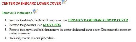

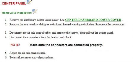

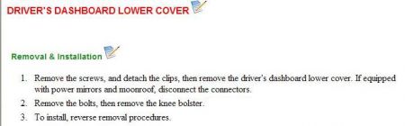

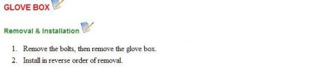

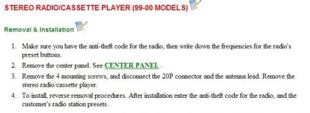

How do I remove the dash for a 1999 Honda Civic to install a new stereo from Walmart? Christmas present.
Please include pictures if possible.

Tuesday, December 29th, 2009 AT 8:14 PM
