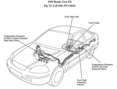

cannot find fuel filter on my sons 1999 honda civic

Hi DeschaneD,
Is is located on the firewall. The item above the EVAP control canister in diagram.
