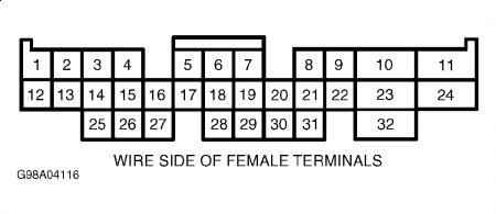

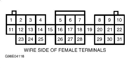

BMRFIXIT
  • 19,053 POSTS
This what I have on flash code17
DTC P0500 & P0501: VEHICLE SPEED SENSOR (VSS) MALFUNCTION
D16Y5 M/T
Test drive vehicle. Using scan tool, check vehicle speed. If correct speed is not indicated, go to next step. If correct speed is indicated, problem is intermittent. System is okay at this time. Check for poor connections or loose wires at VSS and PCM connectors. See appropriate wiring diagram in WIRING DIAGRAMS article. Repair as necessary.
Turn ignition off. Block rear wheels and set parking brake. Raise and support front of vehicle. Turn ignition on. Block right front wheel and slowly rotate left front wheel by hand. Using backprobe set, measure voltage between PCM 32-pin connector "A" terminal No. 9 (Brown/Black wire) and PCM 31-pin connector "C" terminal No. 18 (Blue/White wire). See Fig.
If voltage does not pulse between zero and 5 volts, go to next step. If voltage pulses between zero and 5 volts, substitute a known-good PCM and recheck. If symptom or indication goes away, replace original PCM.
Turn ignition off. Disconnect PCM 31-pin connector "C". Turn ignition on. Block right front wheel and slowly rotate left front wheel by hand. Using backprobe set, measure voltage between PCM 32-pin connector "A" terminal No. 9 (Brown/Black wire) and PCM 31-pin harness connector "C" terminal No. 18 (Blue/White wire). If voltage pulses between zero and 5 volts, substitute a known-good PCM and recheck. If symptom or indication goes away, replace original PCM. If voltage does not pulse between zero and 5 volts, check for short in Blue/White wire between PCM, TCM and VSS. Also check for open in Blue/White wire between PCM and VSS. See appropriate wiring diagram in WIRING DIAGRAMS article. If wire is okay, check VSS.
Wednesday, January 27th, 2010 AT 8:05 PM
BMRFIXIT
  • 19,053 POSTS
http://www.2carpros.com/forum/automotive_pictures/99387_Graphic1_646.jpg
http://www.2carpros.com/forum/automotive_pictures/99387_Graphic2_304.jpg
Wednesday, January 27th, 2010 AT 8:09 PM
