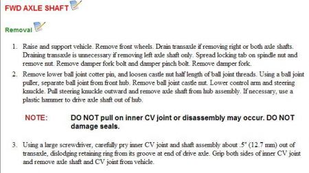

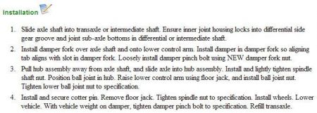

1997 Honda Civic cvc joints
PLUMBBOB1
MEMBER
1997 HONDA CIVIC
Drive Train Axles Bearings problem
1997 Honda Civic 4 cyl Front Wheel Drive
how hard to replace
Thursday, February 11th, 2010 AT 3:48 PM
BLUELIGHTNIN6
MECHANIC
16,542 POSTS
Thursday, February 11th, 2010 AT 5:18 PM
