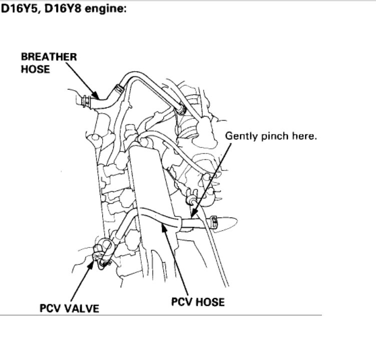

During the removal of the old PCV valve it broke off flush at grommet. What would be the best way to finish this job? I have tried to remove the remainder of the valve with needle nose pliers but this just keeps breaking the remaining plastic valve into little pieces. This is a very difficult area to get to. Not like any PCV valve I have ever encountered before. Please help!

Hi HotRodHonda,
If you can get a small suction hose, that would be the best way to get the remainder out. Break them into smaller pieces and remove with the suction.
If possible, remove the rubber grommet and intake manifold for easier access. Check out the diagrams (Below). Please let us know what happens.
