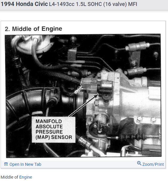

I need to know where the map sensor location for a 1994 Honda civic ex

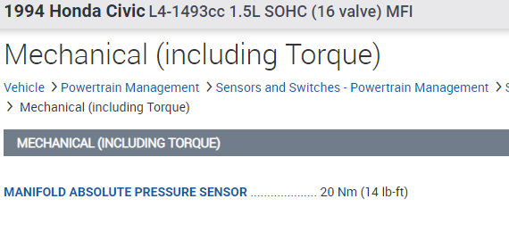

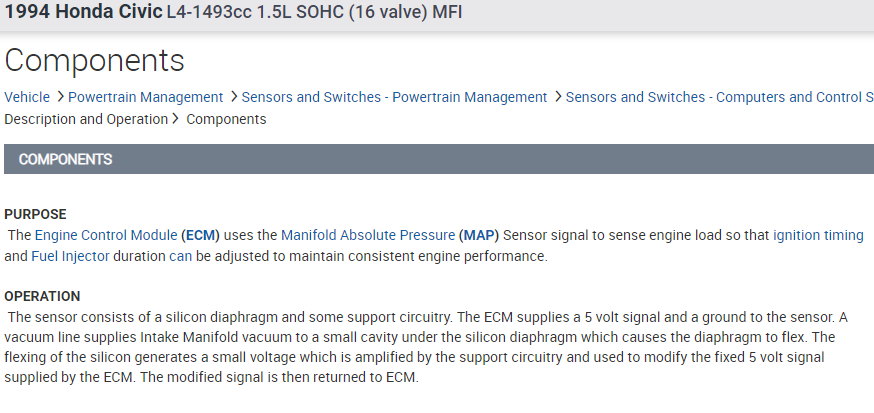

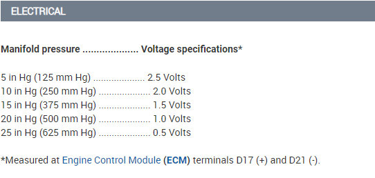

The MAP sensor is located on the top of the engine. See attached picture. I have also included few other specifications.
Let me know if you have any questions.
