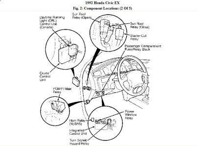

WHERE IS THE FUEL SWITCH RELAY?
Thursday, April 9th, 2009 AT 3:01 PM
KHLOW2008
MECHANIC
41,814 POSTS
Hi JUNKIEMONKEY,
The PGM-FI main relay controls the fuel pump operations.
