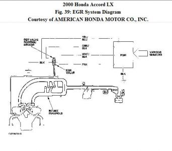

Ok. They said the code is P0401 (not sure if those are zeroes or o's).
They were also saying that it is the upper intake valve that would have to be removed and cleaned. Apparently their "fuel cleaning service" was only flushing the lines with some cleaner. But it still makes no sense how using a cleaner fluid that is supposed to "clean" your fuel system ends up causeing the upper intake valve to clog.

Hello !!
well that code means:
Exhaust Gas Recirculation (EGR) Insufficient Flow
this is the diagram of the egr (courtesy of Mitchel1:
https://www.2carpros.com/forum/automotive_pictures/576_honda_200_egr_1.jpg
looks to me like they didn`t remove the egr to clean it because the ECM its detecting an insuficient flow which means its "blocked" or not opening completely...
also if they said: "upper intake valve " probably they mean EGR i dont know wich valve they are talking about...
Anyhow make them fix your car right !
if they "leave" some carbon to fall off on your intake or if they didn`t fix it right it`s their fault..
let me know if you need more assistance !!

I suspect in the process of cleaning deposits were knocked loose and could be plugging a port in the intake plenum. Once cleaned I would venture the problem disappears. You will need to then reset the code and hopefully that will rectify your problem.

I posted about this before.
Honda has a tsb on this problem. I doubt it was the shop's fault, probably poor timing and a lack of knowledge of this car on their part.
The egr passage in the upper intake gets clogged solid with carbon. The upper intake needs to be removed and the port actually drilled out with a special bit that honda sells. After the port is drilled out (it makes it bigger as well) honda supplies, via an updated egr kit, a sleeve for the port. The kit also comes with a new egr valve. The kit costs about $85 iirc. Most honda dealer will have it in stock. The drill bit isn't included, you have to buy that separate.
