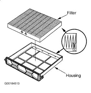

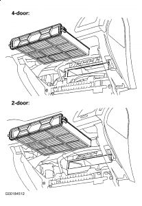

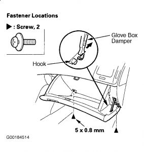

How to I change HEPA filter
Wednesday, March 31st, 2010 AT 1:03 PM
DOCFIXIT
MECHANIC
18,828 POSTS
Remove glove box let it hang down
Remove filter assembly
Replace filter
