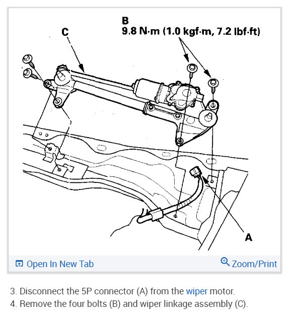

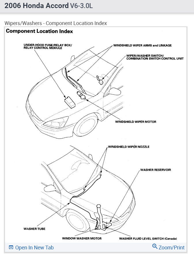

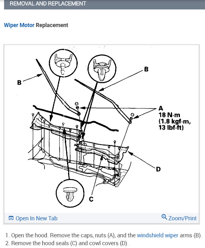

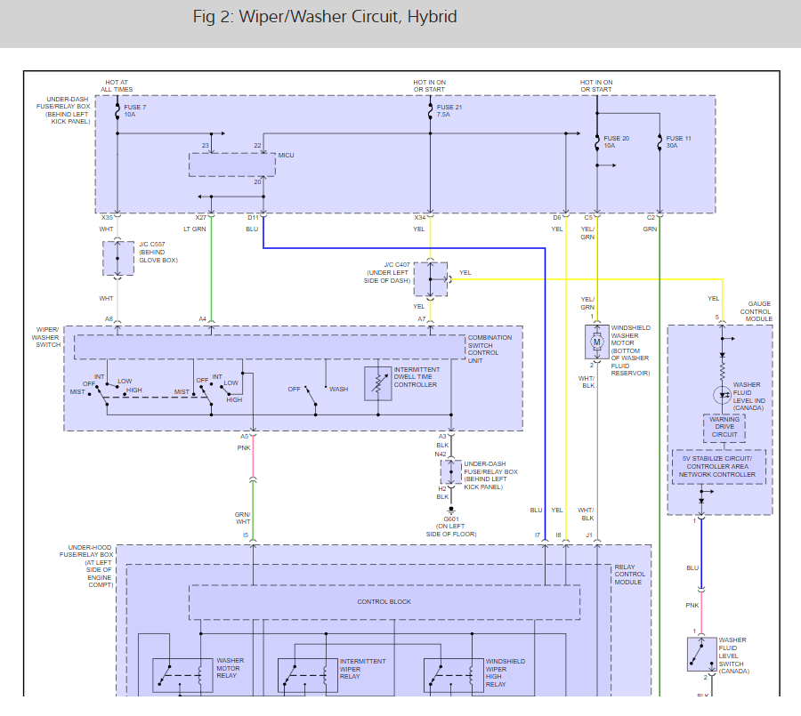

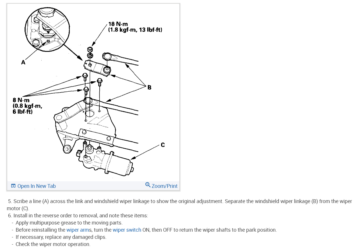

The wipers on our Honda Accord have started moving past the range they are meant to cover. When they go up, the driver's side wiper goes about two inches past the edge of the windshield onto the frame and when they come down they crash down loudly to the bottom. They only work about half the time?
Friday, May 14th, 2010 AT 2:48 PM
10 Replies
HONDA TECH 1818
  • 536 POSTS

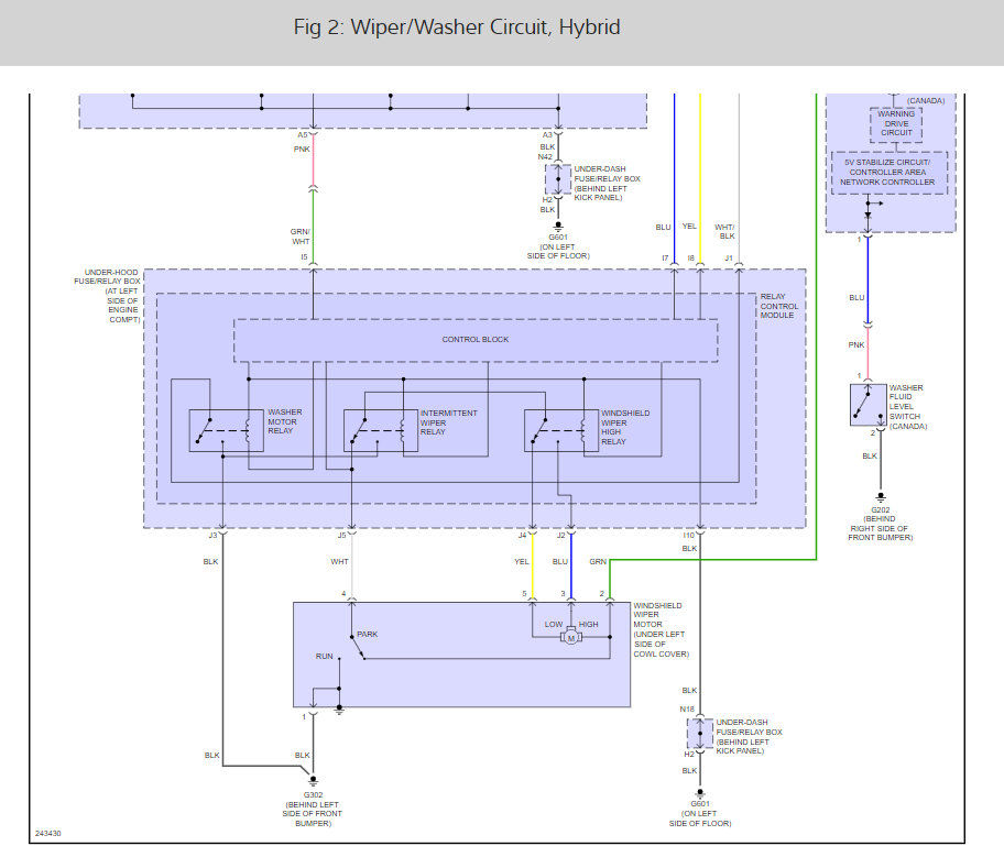

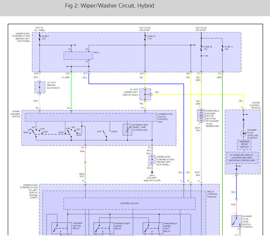

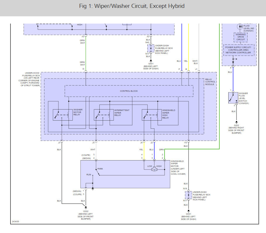

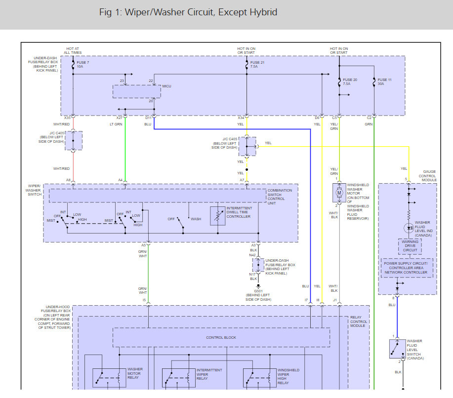

It sounds like the wiper motor and wiper linkage is worn out but to be sure let's use this test light to check for power at the motor and check the linkage here is the wiring diagrams and instructions on how to change the wiper motor and linkage out below.

My windshield wiper is going crazy. When I turn on slow mode, it goes all the way up like it suppose to. When I turn it fast mode, it goes all the way and it the rubber edge of the windshield. The wiper doesn't stop where it suppose to stop and come back down. Can you please tell me what is really wrong with my windshield wiper. I don't want to buy something that will not fix my problem. Thanks for your help.
Monday, January 14th, 2019 AT 12:56 PM (Merged)
2CARPRO JACK
  • 11,533 POSTS
Id check the bushings on the arms to see if one is bad, other than that it sounds like it may be the motor if the blade doesnt hit in other speeds. Is the arm secure (tight) on its mount?

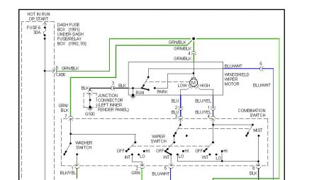

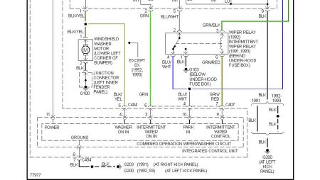

1991 accord wipers stopped working and its blowing fuses now I repladced motor and not blowing fuses but still no wipers?Help
Friday, August 23rd, 2019 AT 4:24 PM (Merged)
KHLOW2008
  • 41,814 POSTS
Hi weezer67,
I have the wiring diagrams here and you can do some testing.
1. Check for power supply to wiper motor Green/Black wire. If washer is working, should not be any problem.
2. With ignition and wiper switch ON, ground Black wire. If wiper works, ground wire is bad. If wiper motor heats ups during this process, wiper linkages could be incorrectly installed resulting in restriction.
3. Ground Blue or Blue/Yellow, if wiper does not work, the motor is bad.
