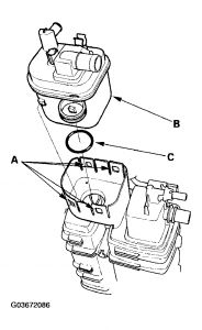

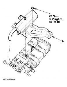

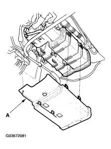

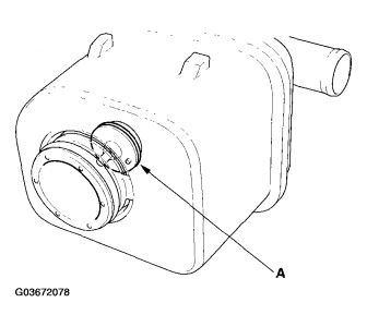

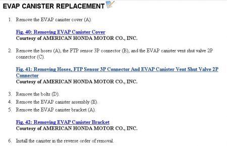

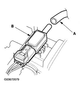

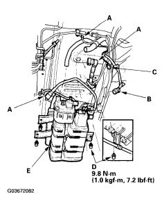

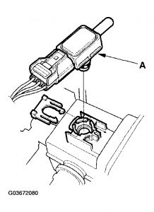

Well finally I took it to dealership and as I suspected it was spider web. But the tech he can't clean it out, he would have to change the part. He quoted me 420 dollars + tax. I was wondering if it is possible to do this at home to save money. Does anyone have ever done something similar?
Jan 27, 2009 at 4:59 AM
ZACKMAN
  • 4,202 POSTS
https://images.2carpros.com/forum/automotive_pictures/55316_06accordp2422_1.jpg
https://images.2carpros.com/forum/automotive_pictures/55316_06accordp2422_2_1.jpg
https://images.2carpros.com/forum/automotive_pictures/55316_06accordp2422_3_1.jpg
https://images.2carpros.com/forum/automotive_pictures/55316_06accordp2422_4_1.jpg
https://images.2carpros.com/forum/automotive_pictures/55316_06accordp2422_5_1.jpg
https://images.2carpros.com/forum/automotive_pictures/55316_06accordp2422_6_1.jpg
https://images.2carpros.com/forum/automotive_pictures/55316_06accordp2422_7_1.jpg
https://images.2carpros.com/forum/automotive_pictures/55316_06accordp2422_8_1.jpg
Jan 27, 2009 at 11:57 AM
