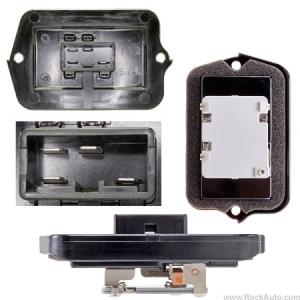

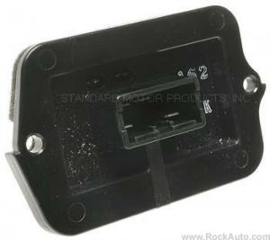

the fan does not work at positions 1 & 2. It is ok at positions 3 & 4
Thursday, September 16th, 2010 AT 4:48 PM
BMRFIXIT
MECHANIC
19,053 POSTS
Very common to be a bad blower motor resister beside blower motor
