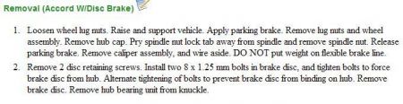

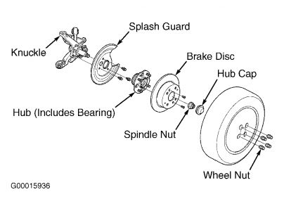

Hi, I have a hum comming from the back of the car. I believe the rear wheel bears are the cause. I bought the bearings yesterday but before I do this I am wondering if you have an exploded view and if there are any special tools needed or tricks to make the job go better. I am fairly competent with mechanics but have never dealt with this issue before. I also bought new brake pads and rotors as long as I am in there.

https://images.2carpros.com/forum/automotive_pictures/261618_Noname_844.jpg
https://images.2carpros.com/forum/automotive_pictures/261618_Noname2_220.jpg
https://images.2carpros.com/forum/automotive_pictures/261618_Graphic_116.jpg
