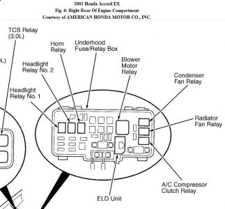

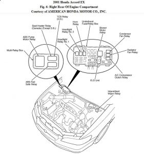

Could you please tell me where I can find the AC relay?
Sep 13, 2009 at 6:36 PM
KHLOW2008
  • CAR REPAIR CONTRIBUTOR
  • 41,814 POSTS
Here is a diagram of the location. Unplug the relay and if compressor stops, swap with condenser or radiator relay and retest.

I checked relay and it works. Is there anything else I can check?
Sep 16, 2009 at 11:34 AM
KHLOW2008
  • 41,814 POSTS
Did you swap the relays? The fault could be the relay is stuck in the closed position causing the compressor to remain on.
Sep 16, 2009 at 11:50 AM
KALEV001
  • 5 POSTS
[quote:432077974b="KHLow2008"]Did you swap the relays? The fault could be the relay is stuck in the closed position causing the compressor to remain on.[/quote:432077974b]
Yes I did that. Does not help, the AC is on all time still.
Sep 17, 2009 at 10:10 AM
KHLOW2008
  • 41,814 POSTS
Bad news. The compressor clutch relay ground control is through the PCM and since relay is not the fault, either the PCM is faulty or the wire from relay to PCM is shorted to ground.
Unplug PCM and Ac clutch relay and test the PCM terminal A17 ( RED wire ) for continuity to ground. If continuity exists, the wire is shorted to ground.
If no continuity exists, the PCM has to be substituted to test.
Sep 17, 2009 at 10:30 AM
