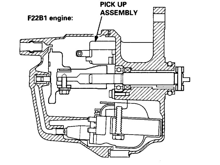

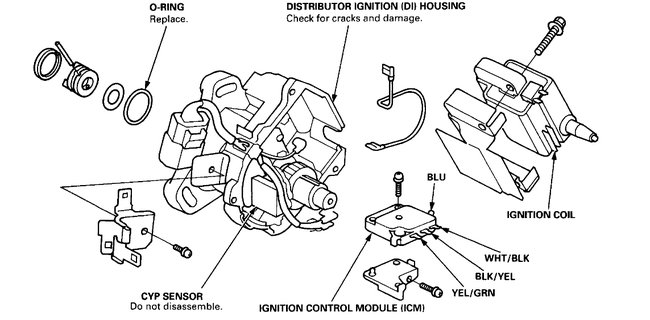

This is a code for one of the sensors inside the distributor. It contains three sensors which send signals to the PCM for the fuel injection.
In most cases, we replace the entire distributor with a new cap and rotor as well. Cross arcing inside the cap may be the root cause of failure of the sensor.
P1382
The scan tool indicates Diagnostic Trouble Code (DTC) P1382: No signal in the Cylinder Position (CYP) sensor circuit
DESCRIPTION
The CYP Sensor detects the position of No. 1 cylinder for sequential fuel injection to each cylinder.

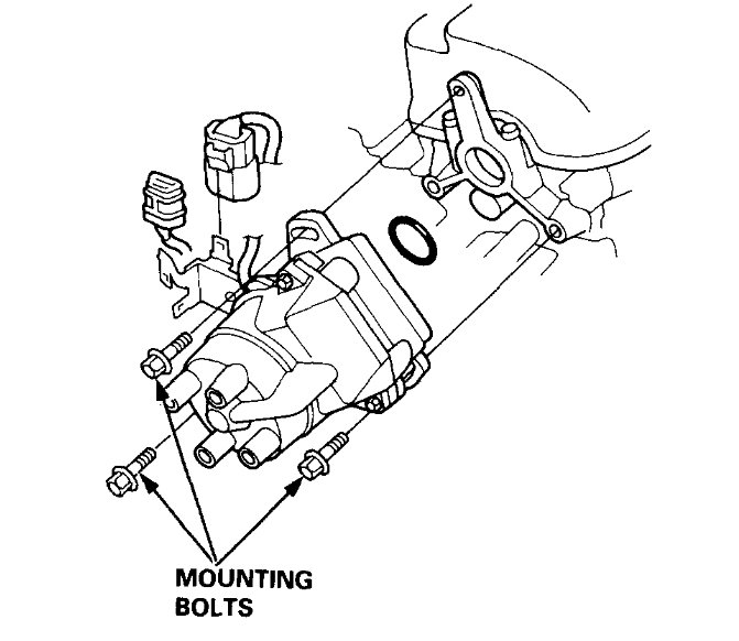

REMOVAL
1. Disconnect the connector(s) from the distributor.
2. Disconnect the ignition wires from the distributor ignition (DI) cap.
3. Remove the distributor mounting bolts, then remove the distributor from the cylinder head.
