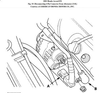

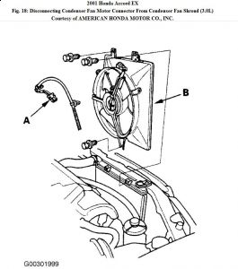

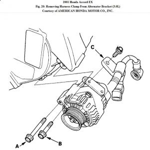

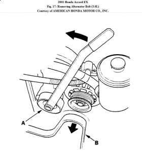

Hi honda2001, Here are the procsdures 1 . Ensure you have the anti-theft code for the radio. Write down the frequencies for the radio's preset buttons. 2 . Disconnect the battery negative cable. Disconnect the positive cable. 3 . Move the auto-tensioner "A" to relieve tension from the alternator belt "B", and remove the alternator belt. See Fig. 17 . 4 . Disconnect the condenser fan motor connector "A" from the condenser fan shroud. See Fig. 18 . 5 . Remove the condenser fan/shroud assembly "B". 6 . Disconnect the 4-pin connector "A" and Black wire "B" from the alternator. See Fig. 19 . 7 . Remove the mount bolt "A" and alternator bracket mounting bolt "B". Remove the harness clamp "C" from the alternator bracket. See Fig. 20 .
