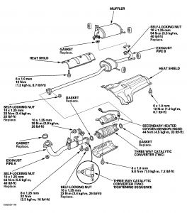

check engine light is on and mechanic told me to replace catalytic converter so i ordered one from online website. Now i need some help in locating the catalytic converter and also need the instructions for how to replace it..?
Do I need any joining tools like welding or any thing...?
Converter which is already installed and which I ordered both says Direct Fit...
For locating the catalytic converter pictures of the actual converter are greatly appreciated..
Please help in this matter...
Thanks
Aug 2, 2008 at 11:22 AM
KHLOW2008
  • CAR REPAIR CONTRIBUTOR
  • 41,814 POSTS
Hi hcpatel22, You need to get under that car.
https://images.2carpros.com/forum/automotive_pictures/192750_AccordCatalyticConverter98_1.jpg
